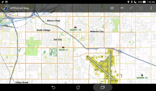

Right now I use Gaia for navigation (but plan to switch to Backcountry Navigator once my Gaia subscription expires, as Backcountry Navigator can display APRS as a layer over the basemaps).
The APRSDroid basemap I use is an optimized Open Street Maps file of the US; you cannot navigate or display a GPX file with APRSDroid.
When in the backcountry I use APRSDroid to see the location of other rigs in my group and to send messages.

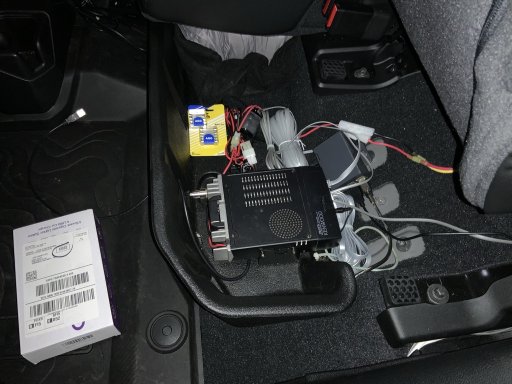

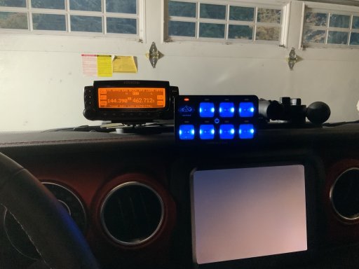

So I pulled the trigger on the Icom 2730a and Mobilinkd. Wanted a mobile for the GX for a long while and finally did it. I hope those Japanese radios live up to their hype. I really wanted to run some APRS stuff and the 2730a has no native way to do that so I figured the Mobilinkd would be worth a shot to try out.
Anyone running APRS?
Anyone using it for stuff in addition to position, like for texts/emails/status?
What about the mobilinkd tnc?
Anyone using the 2730a? How do you like it?
