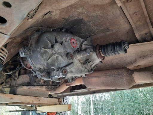

Today it was working time. Together with @Claus_za I did change my transfer case.
We had almost no issues.
Just three.
1. A bushing from the shiftcable was gone. So I had to build one myself. No problem there.
2. When we tried to fill up the transfer case we did forget that the breather hose was down, so we lost like 600 ml of oil. Lucky me I had some spare.
3. The upper bolt on the exhaust side we just could turn, so after getting annoyed I made a slit under the gear lever. Then that problem was solved. Next time, which I hope will last a while I can easier acces that bolt.
The ramps hold the care perfectly and driving of it forward made things very easy.
All good!!
The breather hose we did extend that one and now it is up and above the coolant expansion thingy.
It was a good day of work.
