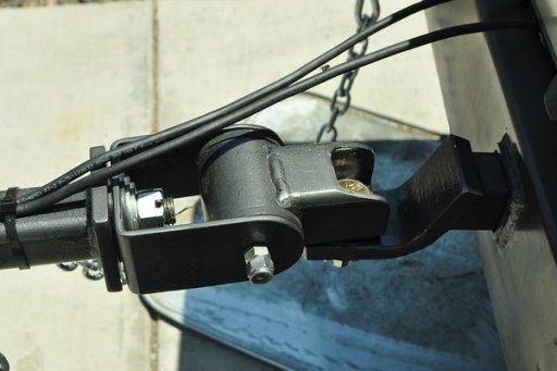

Check the pintle mount to receiver fit. My M1101 knocked around terribly. The mount was very undersized. Welded beads and milled flat, test fitting as I went until I can barely get it into the receiver. Now 95% or better of the noise is gone. Lost picture, but did post in "what did you do with your rig today" about the mod some time ago.
