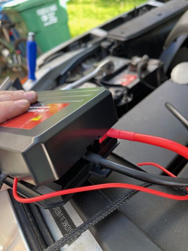

Took a gamble on a cheap fuse/relay box and switch panel. So far it's been great, but I can't close the fuse/relay box lid, because they don't account for the battery cables. Hah!
What could be the best way to go about making this more water resistant?
I'm thinking I could use a large drill bit to carve out a space for the cables, then find or make a gasket that goes around the top lid and bottom.

Who says it has to? Hog out holes for the cables. Close it up.
If you keep the holes small, grease could seal it up enough.

thats hard to drill
why not get a rat tail file close to the diameter of the cable and file a nice slot exactly the length you need. slightly undercut the slot and you will have a tight seal just by compressing the cable a hair when you screw down the cover
if you dont have a round file, use a fine tooth saw blade like a hacksaw and cut the two sides and then break the tab with pliers and then find a bolt the same diameter of the cable and use it going back and forth to file out the round at the end of the cut to match the cable radius. you can use a bolt to file soft plastic like that

Yeah, cut a relief for cable entry using your choice of tools, then Sikaflex or similar to seal.

. . . and coat all connections and contacts with dielectric grease. . . I like CRC Marine Premium.
