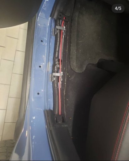

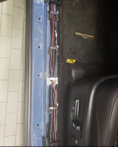

We have a Dometic CFX75DZW and I used 8gauge wire and ran it from the Blue Sea Fuse block (used 7.5amp fuse) installed for accessories, at battery, through firewall and then along the interior. I removed the kick panel and kick trim pieces along driver side, and trim across the rear cargo at carpet. Then used right side panel of our 4runner, where I used a drimmel tool to cut out a space to mount a Blue Sea Systems (PN: 4356) where I can cut power on/off for for the fridge when needed. This worked great for camping for multiple days when our 100w solar panels were hooked up. We also use it every weekend for groceries with no issues. Recently we upgraded to the Genesis Offroad Dual Battery system for 5th gen T4R with Odyssey Performance Batteries. This allows us to run the fridge at the beach without lugging around heavy solar panels. We do intend to get a small solar blanket for the long stationary trips, just to keep the batteries topped off and not damage them. If you'd like pictures of this, you can find them under our IG: BigBlueOx_TRD
Or, I edited this to attach the photos here...
