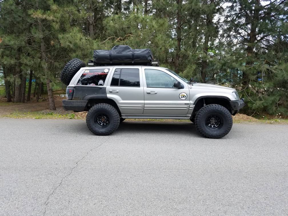

4" IRO front long arms, adjustable short arms in the back. 265/75/17 32"s

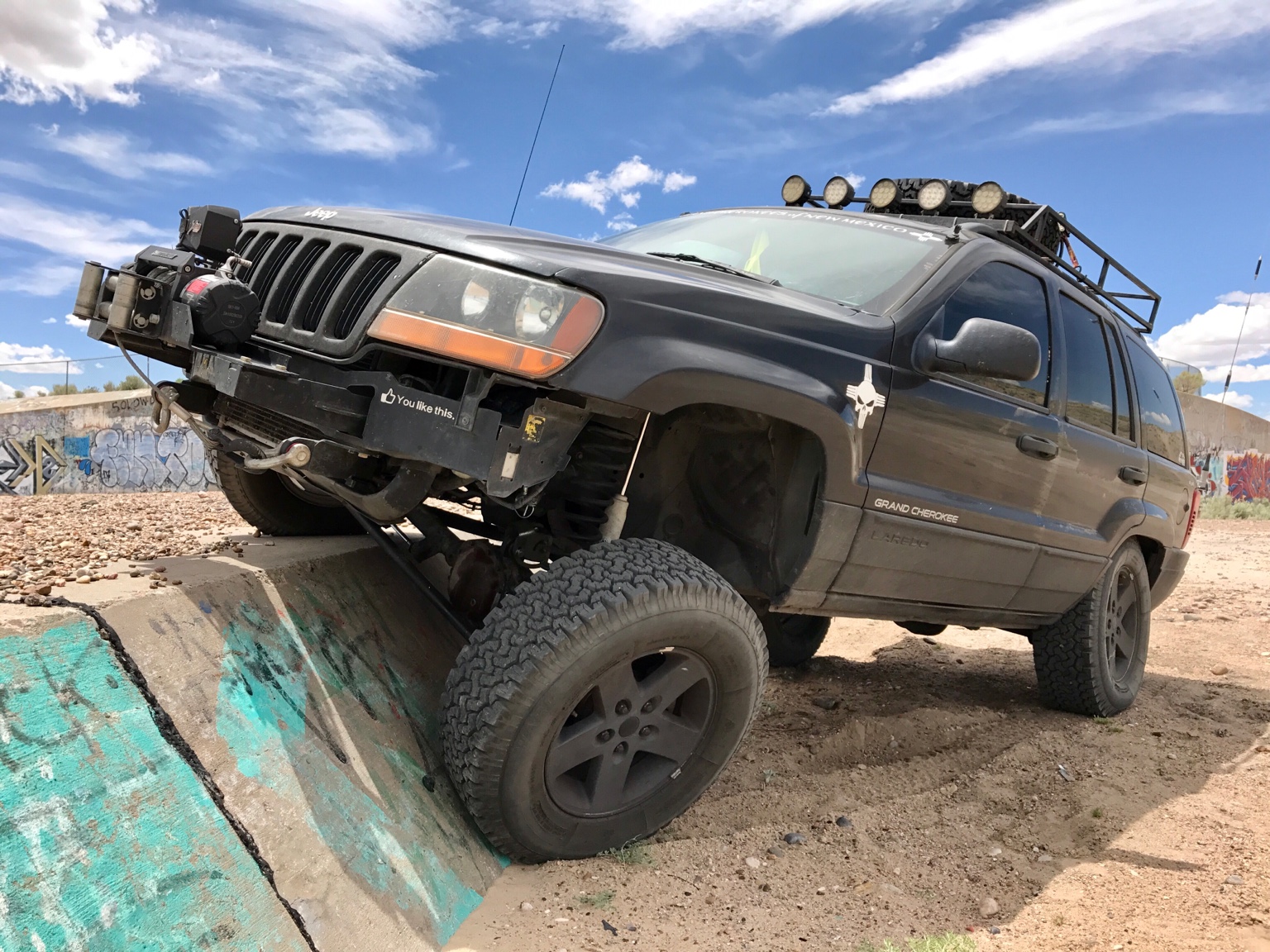

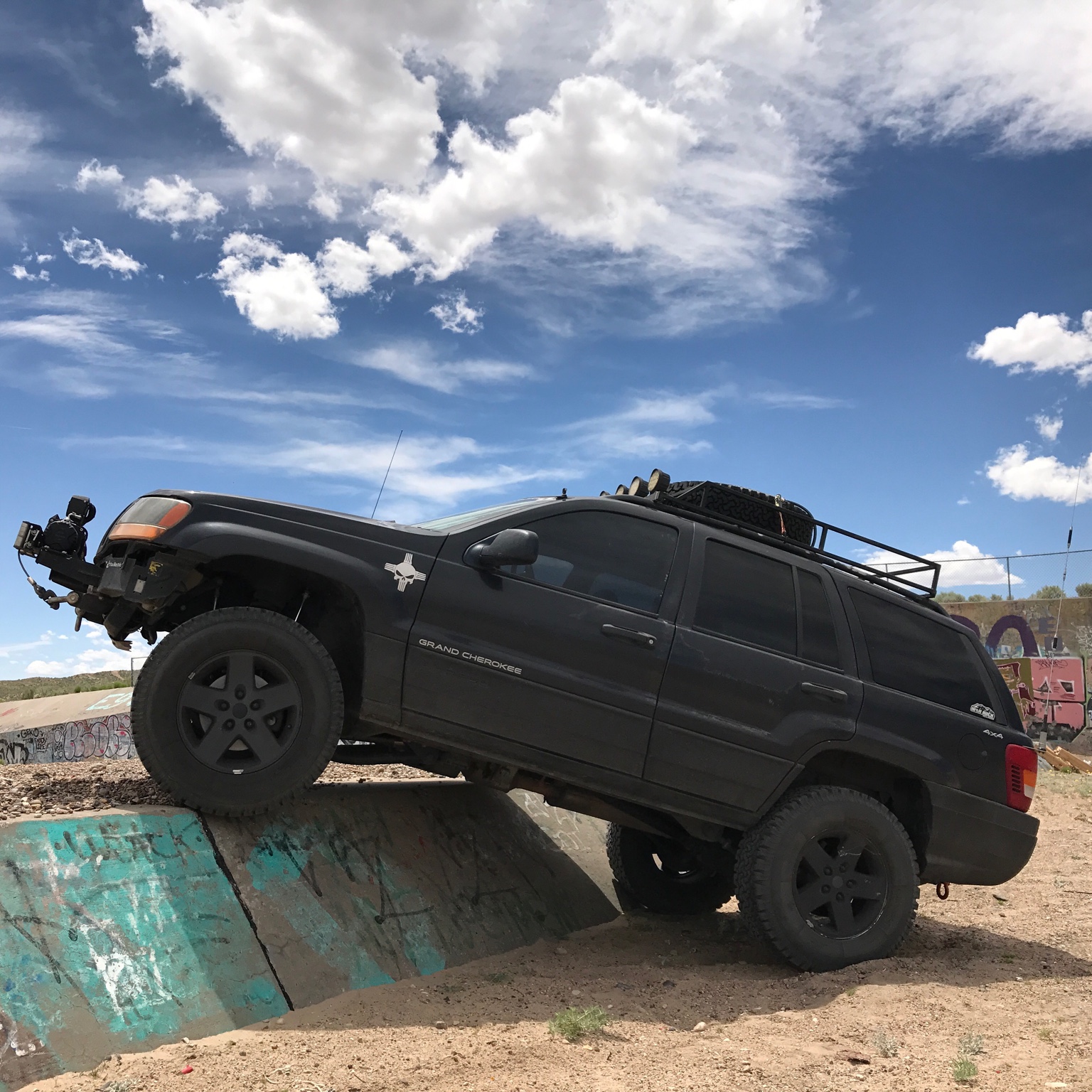

Yeah I did similar to mine. Bought a junk Overland and took the axles from it. It was from Tenn though and the front coil holders were gone. So I bought the IRO ones and welded them on.
Reactions: NWjeeper
