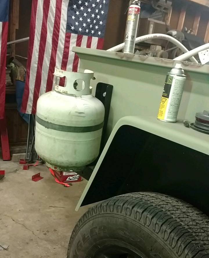

Thanks bud! It's a slow process but moving along nonetheless. Planting season has been slow starting so Saturday I fabbed up a propane mount out of some spare channel from the frame. We will be converting an old Coleman 425f stove to propane.

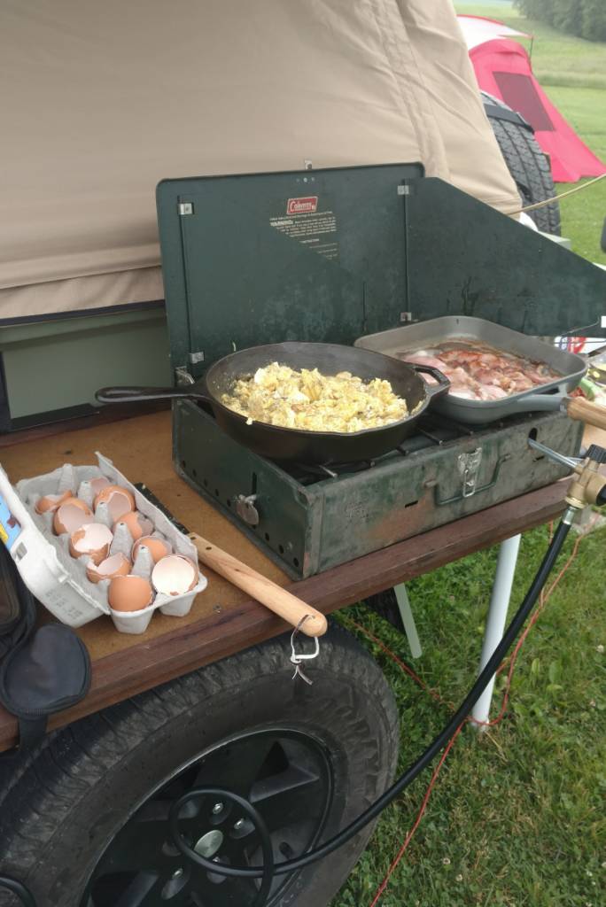

The rear pelican case houses the stove, gas adapter and utensils. My dad and I made the shelf to go on the fender thru the week. I used a piece of 1-1/4" PVC with a 1" PVC insert, drilled a couple holes in the insert piece and use it as an adjustable leg for the table support. Used the same concept for the flag pole as well with the remaining pipe I had.
It's been a insightful trip, we definitely need rear supports to keep the trailer from rocking too much and a lid would help be able to fill the trailer bed with bulkier items.

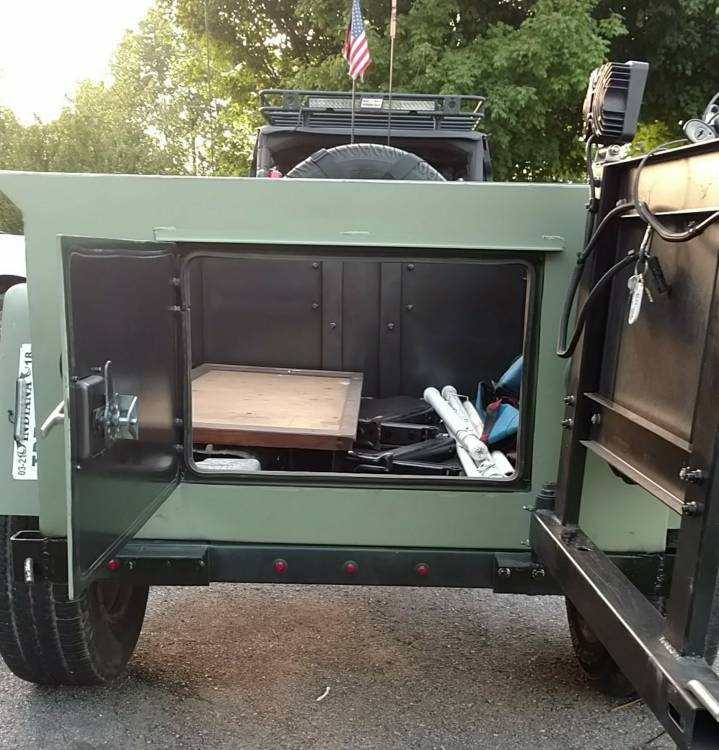

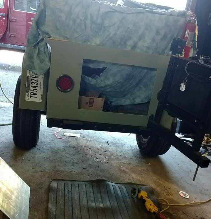

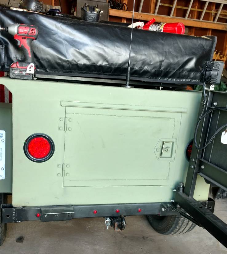

After mustering up the courage to cut a hole in the rear wall for a door I'm happy I did. It makes everything so much easier.

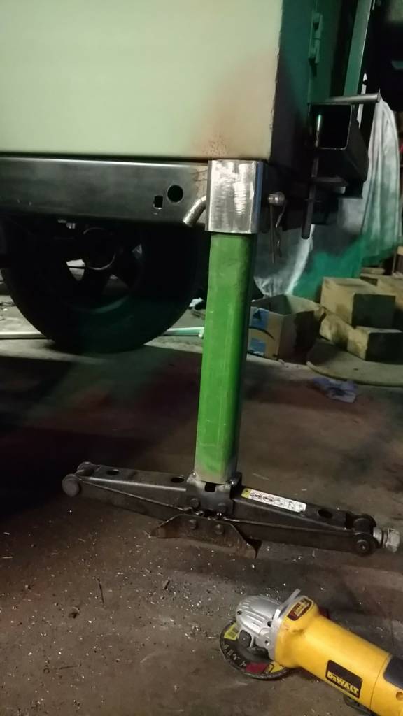

I also scavenged onto a couple jacks from my Jeep and my wife's since their both lifted and made some cheap stabilizers. Hint: if you cut the eyelet off and weld a nut in its place you can have electric jacks if you bring a battery impact with you.
Also made a anti-theft plate that goes in the tongue in place of the ring in case we have to leave it somewhere for some reason. Its a cheap deterent at least.
Lastly I finally bolted the hitch to the rear end for recovery purposes.
Thanks for your encouraging words guys this is my first build thread if you have any questions of more details post em up!

Good looking trailer, where did you get the closing/locking mechanism for the rear door. I'm drawing up plans to make my own from scratch and really like that method to close the door.
