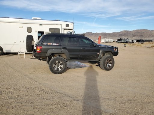

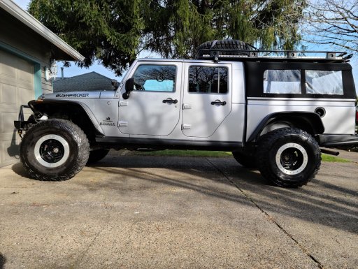

The Brute is cool and all, but what can you tell us about the WJ? I'm a big fan and been building on one myself.My name is Wade and I live in the Vancouver WA area. People in the area recognize the Black WJ I drive. I also have an AEV Brute DoubleCab (Silver and Black). Any questions, feel free to reach out.View attachment 191985View attachment 191987
GauthWJ: My black 04WJ was first built in 2013 and has been through various iterations since. It now has custom front and rear axles built by East Coast Gear Supply. The rear is a Dana 60 built with JK outers and ARB Lockers. The front is a HP44 with 32 spline RCV shafts and an ARB Locker and PCI Hydro Assist connected to a Barns billet aluminum tie rod. Both have 4.88 gears, JK big brake kits (13” front and 12.5 rear), and are built to take a beating. In the Picture the WJ is at 8” of lift but currently has 6.5 (performs better) on 35s. The suspension is IRO Rock Link with FOX Factory series remote res shocks and a IRO skid plate. The exhaust is custom and I just replaced the engine trans and transfer case with new or reman. A company called Fast Specialties did the work. The Engine is still a 4.7 HO but now has all the latest upgraded components. It was installed about 3 months ago. The Trans is a normal 545rfe with a shift kit. The Transfer case is a 242HD (made for V8 Grands) with a slip yoke eliminator. The driveshafts are IRO custom and the entire drivetrain has about 3000 miles or less on the different components. It has a rear bumper with a tire carrier built by Proto Fab in Arizona and the front is ARB. It has two Viair 480C compressors the feed into a 2.5-gallon tank that maintains 200 psi before being regulated down. It will air up tires fast, run air tools, or blow up air mattresses. Track bar and drop are IRO and there is a lot that I didn't mention There is a lot going on with that WJ. It is one of the best-built most capable most have ever seen.The Brute is cool and all, but what can you tell us about the WJ? I'm a big fan and been building on one myself.
The 242HD has been rebuilt. Borgwarner chain, timkin barings ect. So it is $1200.Sounds like a pretty good set up, mines not there yet but someday. How much you want for the T case? I've already swapped mine to the 242hd but will need to do the SYE here shortly when I go up in the lift.
