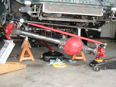

Back when I had a '99 Toyota 4Runner, I pushed that little 4Runner to the max, breaking plenty of IFS axles, then I installed a 3-point D44 Solid axle on it. It was a rock-crawling beast.
I was able to run 37" tires, given I bobbed out the floorboard to accommodate the suspension stuff.
I know about broken axles, and what works with IFS.
