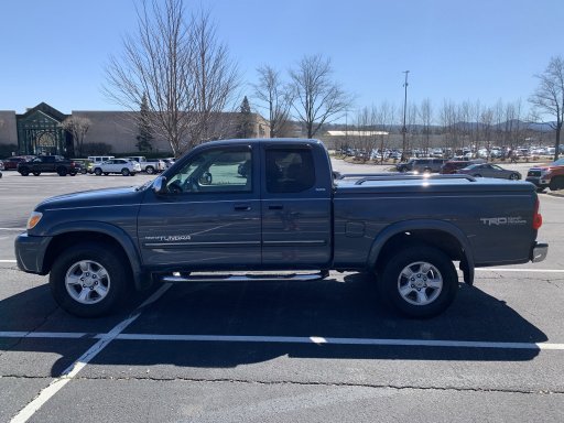

Tundra. No reason just.yhink it will.do what you want it to do.
Good luck with your search.
Btw what not to get.
Acess cab tacoma. I have one too small.
Good luck.
