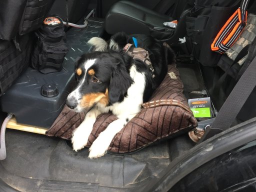

I drive a Toyota Sequoia 4x4 and use the the Front Runner 13.2 gallon slanted water tank. It is designed to sit behind the rear seats and is angled to snug into the void. It only steals about 5 to 46 inches from the rear deck load space. Its location is great for vehicle balance as it is nearly center (fore and aft) in the vehicle. The outflow is a threaded spigot located near the bottom. Front Runner also has accessories like water pumps to plumb the water to showers etc. It is all a little pricey but well designed and durable.
Since I do much of my travel in dry country it is important for me to haul water and moving 6 gallon jerry cans around the cargo area every time I unload was breaking this old man's back. I do carry a small collapsible jug that I fill from the tank for camp use.
