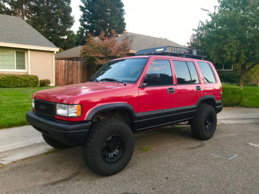

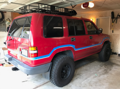

1) Are you happy with it? Very
2) Did you do it yourself? Yes
3) Would you do it again? In a heart beat
4) Did you roll or spray on? Roll On Herculiner
5) What issues did you run into that you didn't anticipate? None other then the particles that fall off the roller and stained the garage floor. Like everyone says the key is to prep well. The kit came with a scotch pad which worked great for the paint but the bumpers I had to use 80 grit sandpaper to scuff up. I didnt think about doing this at the time but I should have also used a plastic adhesion promoter on the bumpers.

*** I forgot add that it only looks so shiny when it is fresh. Once it ages a little bit, my became more of a satin finish.***
