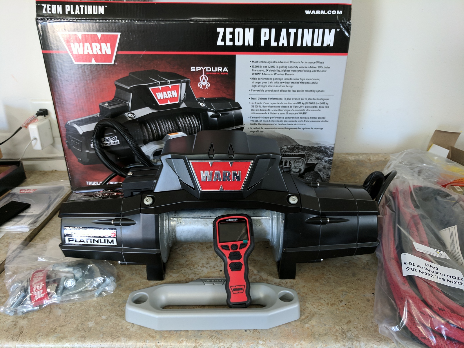

Unsolicited Naked Warn Zeon Platinum 10-s Winch Porn to tempt you away from chinesium winches.
