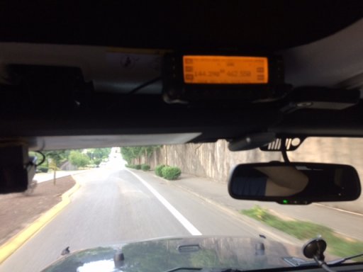

  1. Modified Kenwood TMD700A - UHF/VHF including APRS (terrestrial and sat), FRS, GMRS
  2. Kenwood/Baofeng UHF/VHF HTs for camp/walking around
  3. CB radio to be installed (not in a rush, yet)
  4. Outernet Dreamcatcher satellite data RX (hardware acquired, enclosure in progress)
  5. Valentine 1. It is a receiver... ;)
Forgot to add the Rino 530 - my goto waypoint/track collection device. It is a GPS plus FRS/GMRS radio, oh so handy for overlanding!

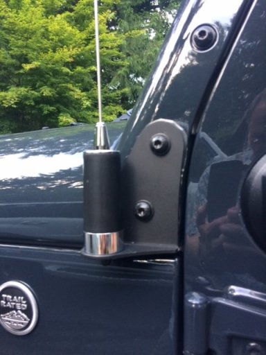

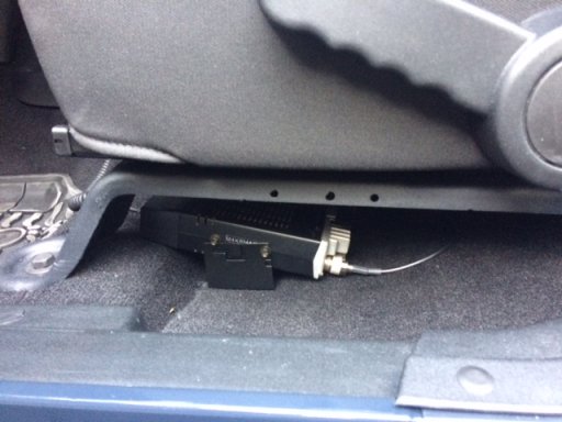

New Jeep, just installed TMD700A. I used a Rugged Radios JK antenna mount (with vinyl paint protector between mount and paint), found a bolt sticking up from floor under driver's seat to attach radio mount to and placed the head end up on top of the driver's side sun visor. I don't use the sun visor and have other stuff stuck to it (V1, garage door opener, etc.)
Have not tested SWR yet but am getting APRS packets in and out and voice to/from an HT sounds great.

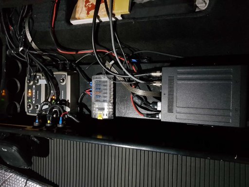

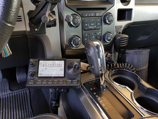

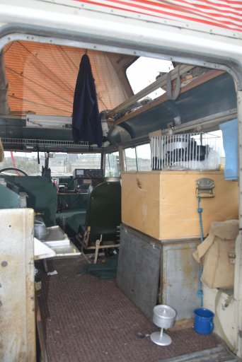

ICOM IC-7100 All band/All mode transceiver
Head unit
Main Unit with other electrical goodies

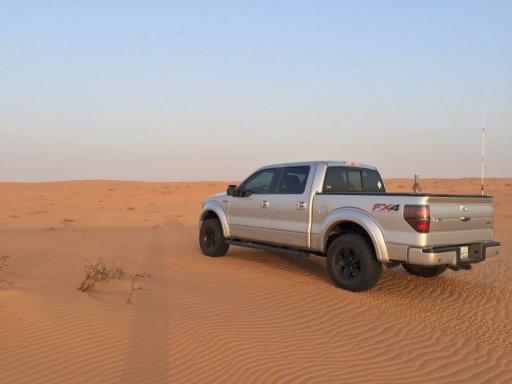

As for antennas
A dual bander VHF/UHF
And ICOM AH-4 mated with a whip that will tune from 40m to 6m ham radio bands + 11m CB radio
My rig but the whip was removed but you can see the spring
