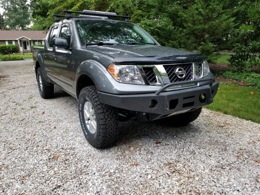

I installed a suspension lift. On the front I installed SPC upper control arms, Radflo 2.5 coilovers with 650 Med/HD springs, and Nissan camber bolts. I also trimmed the coil buckets so the ball joint will clear them even if adjusted all the way in. In the rear I installed a Deaver add-a-leaf and Bilstein 5100 shocks. I got an extra 2 inches in the rear, and 2.5 inches in the front. I'm researching tires now, so that will be the next thing to go on the truck.

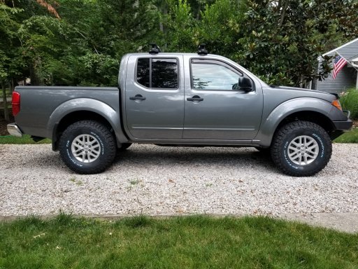

I got some new tires: Bfgoodrich All Terrain T/A KO2 in LT285/75R16.

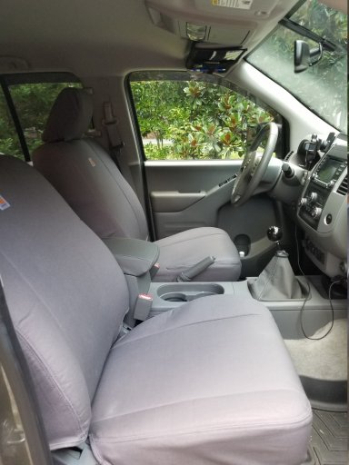

Installed some Carhartt Precision Fit seat covers, a ProClip cell phone mount with Scosche Qi wireless charging holder, and a visor organizer.
