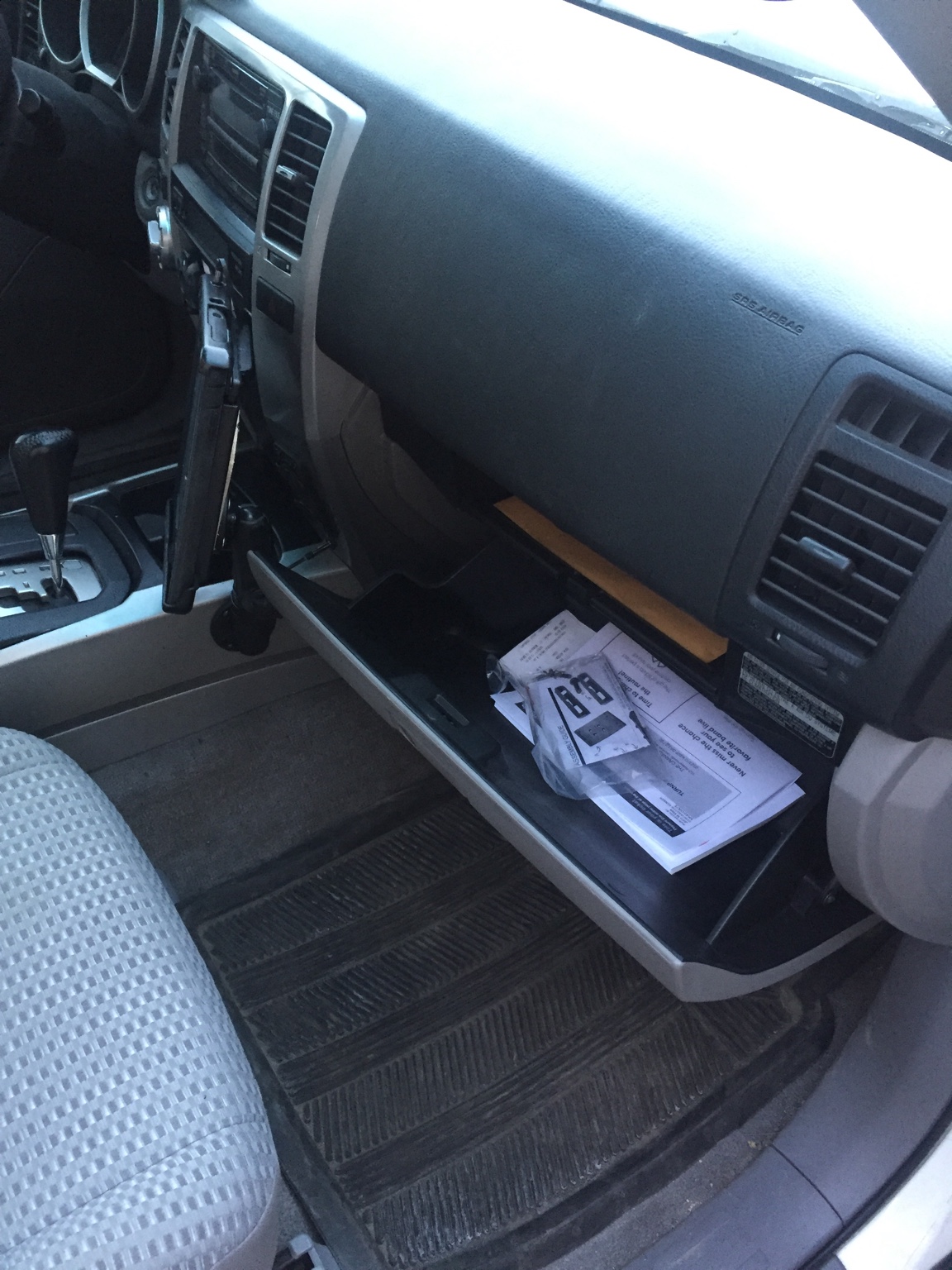

@mattymais I would be very grateful for any help you could provide. I am looking for the exact same setup as the one that you have. Is your tablet the Ipad Mini 4 with an Otterbox Defender case? If so, I would be very grateful if you could provide me with the RAM part number for the tablet holder. From what I can see in the photos, it seems to perfectly hold the Ipad in place with hopefully no vibration. Thanks for your help. I eventually plan to install Gaia maps on it.I finally got my ram mount installed tonight. I had to modify it some by am pretty happy with it overall. Not that it's a huge issue or need, but my glovebox opens with it installed. Still playing with Gaia too

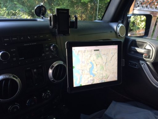

If you are plugging in a USB plug into your 12v plug there are lots of options. I have this one and it works well. AUKEY CC-S1 Car Charger, Flush Fit Dual Port 4.8A Output for iPhone iPad Samsung & other - BlackI ran GAIA on a day trip last weekend, following a route I had created. Over the 9.5 hours using the GPS feature, I found that by my last waypoint, my iPad was down to 15%. I had it plugged into the USBs in my Jeep, and the device showed it was charging, it just could not keep up with the power use, I am assuming due to the constant GPS tracking.
Anyone had this issue and has advice on a better power source to keep my iPad charged?
Thanks in advance.
I will have to try that one. I tried a couple I had, but when I plugged in the iPad, it showed "Not Charging". I then discovered 2 USB's in the center console that when plugged in gave the lightning bolt icon. It may have been that I was using an iPhone cable; when I pulled out a 6-foot iPad charging cable I purchased for work, the cable itself is a lot thicker than the one I was using. I'll give the USB plug you have suggested and the thicker cable a shot next time we are out!If you are plugging in a USB plug into your 12v plug there are lots of options. I have this one and it works well. AUKEY CC-S1 Car Charger, Flush Fit Dual Port 4.8A Output for iPhone iPad Samsung & other - Black
The issue is the ports don't have the higher amp output.m required. So the plug I showed solves this problem. If you ever install additional ports like what Bluesea offers make sure you get the higher output versions.I will have to try that one. I tried a couple I had, but when I plugged in the iPad, it showed "Not Charging". I then discovered 2 USB's in the center console that when plugged in gave the lightning bolt icon. It may have been that I was using an iPhone cable; when I pulled out a 6-foot iPad charging cable I purchased for work, the cable itself is a lot thicker than the one I was using. I'll give the USB plug you have suggested and the thicker cable a shot next time we are out!
