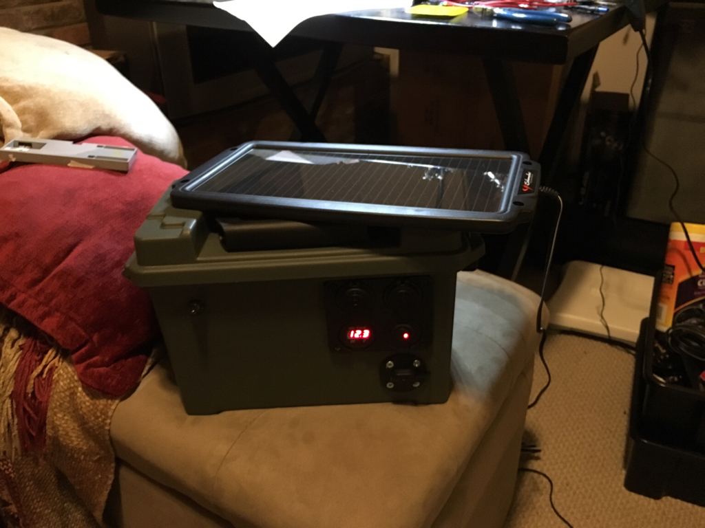

Here's my homemade AGM based solar 200WH power pack in an ammo box
, not enough for a fridge, but definitely for work light and recharging stuff...
Homemade? That's awesome !
