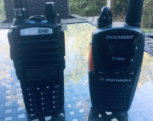

I got it all working, I set the top VFO for Frequency and the bottom for Name. I had these old Motorola’s from my kids scout days and tested. Works great. Thanks for help.53A19471-3135-49A1-B4C0-383CF6501973.jpeg
