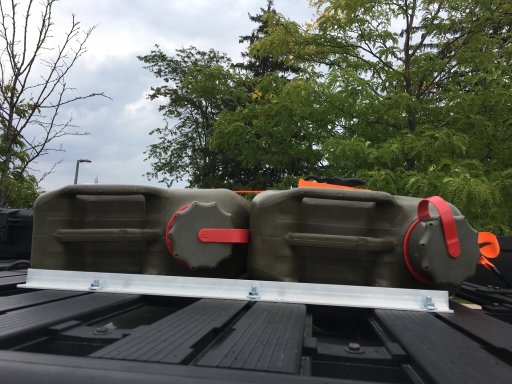

I have 4 wavian, around a decade old. I give them 5 stars they are exactly as they should be. Toss the CARB spout the new ones are forced to provide you with where they belong. (in the trash) They all seal AIRTIGHT, even if overfilled and laid out in the sun to bake.
I have 8 from deutsche optik, one of those has a small manufacturing defect keeping it from being airtight. The other 7 are GTG and the price is in line with their quality. I give them 4 stars. Downsides are only available in OD green, and the locking pins are NOT in the same realm as the wavian pins. They lock the lid shut sure, but they do not load the seal as well as lock the cap to prevent rattles. That is where the wavian's are worth their $$$ IMHO.
With the wavian if you need/want a proper spout these days- order the one below. It is what they should be equipped with if it weren't for CARB's meddling.
https://wavianusa.com/long-nose-flexible-pouring-spout-olive-drab.html
I just use a shaker siphon to fill the tank without the jerry cans ever leaving the roof rack.

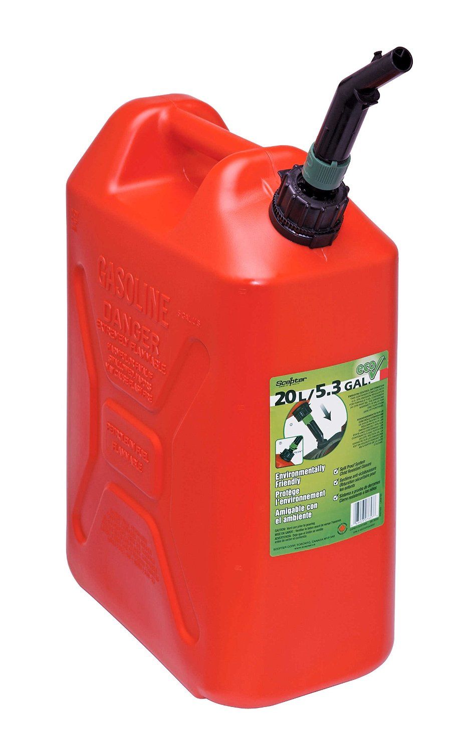

I'll give a brief rundown of the main differences between the Scepter ECO vs the Scepter Mil-Spec. So we are clear on the difference, the mil spec ones look like this:
Scepter Eco look like this:
As you can see the biggest visible difference is the handles and the spout; the Military has one oversized opening where the Eco has a small opening. the Milspec also has 3 handles on the top where the Eco only has one. The Milspec is also much thicker; the whole product though is FAR greater than the sum of it's parts.
I have experience with both and hopefully someone will chime in with a similar review of the metal cans from various manufacturers.

Scepter Eco
Pros:
- Cheap
- Ubiquitous - every hardware store in N.A. sell them.
- All-in-one solution, with spout, vent, and everything sold with each can and stored inside the can itself.
Cons:
- Thinner plastic
- Leak resistant, but may spill if stored on side and absolutely will vent vapour so no good in enclosed spaces.
General:
These red cans are handy for around the house and I have several. They are cheap, light, and easy to toss in the truck to go to the local gas station for lawnmower gas. For 99% of the population, they are good enough.
I wouldn't use them for Overlanding though because they are not very durable. The typical conditions of an overland rig include a lot of bumps and bounces, and the plastic is softer on these cans which will rub through relatively quickly if there is any movement. Plus, the movement of gas tends to off-gas the fuel into vapour which will push its way out of the can; this can also happen with heat. Basically, any kind of internal pressure will blow past the seal and you will lose fuel over time. This is compounded if the can is stored on it's back or side, which is not recommended for these cans (As the vapour pushes past the seal, any fuel against the seal will also leak out). The vapour alone is enough to cause severe medical distress in enclosed spaces, so these should not be kept inside. Keep in mind this also applies to things like having your RTT hanging over the back of your truck with Cans mounted on the back -- if they get warm and vent, guess what your tent smells like forever?! Not to mention the physical sickness.
The other part that annoys me with these cans is the quality of the caps, spouts, and vents. They ALWAYS develop leaks and are rigid, so there's a good chance of spilling or damaging the nozzle when hefting it up to pour it into a lifted rig. Plus, because there are some small parts (the internal cap cover and the vent cover) it's easy to drop and lose those items in tall grass or offload and not be able to seal your cans.
I also don't think these are designed to float, which may be necessary in some water crossings.
Perfect For: Around the house, medium-term fuel storage.
I've got opinions on the metal cans (propensity for denting, rust) but since I have no first hand experience I'll wait for someone else to chime in.
