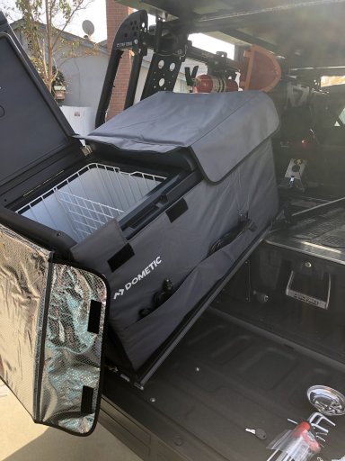

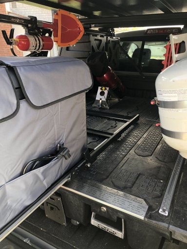

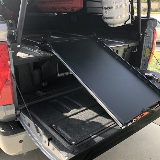

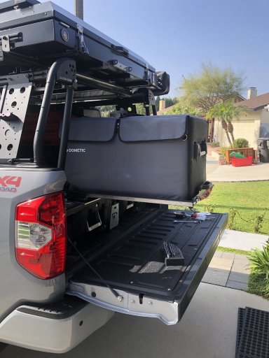

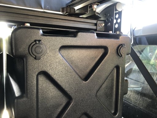

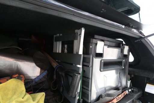

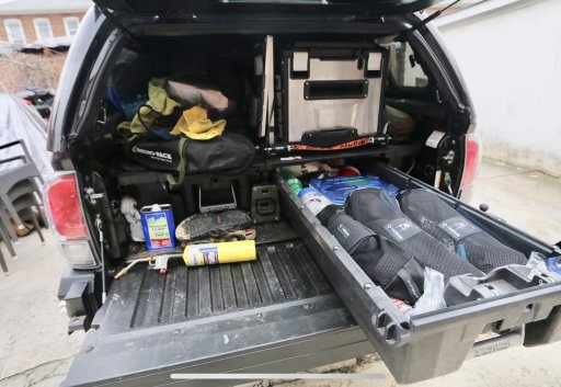

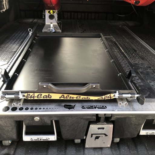

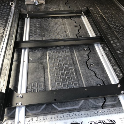

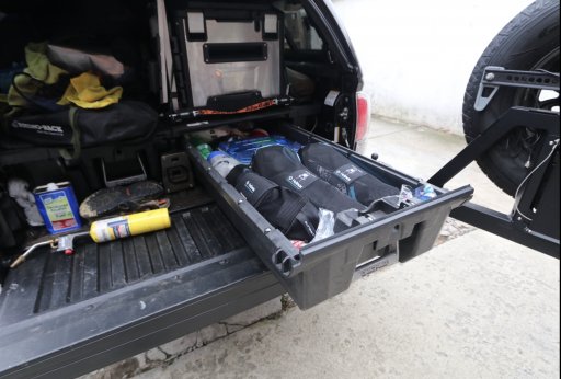

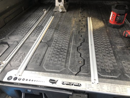

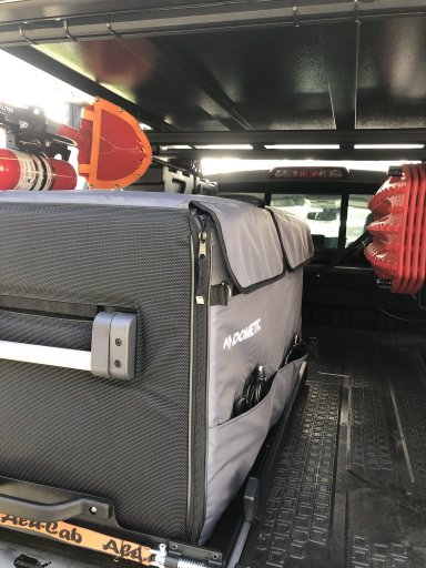

Got a Dometic CFX75 and a Alu-Cab fridge slide from OK4wd. OK4wd gives you 50% off the fridge slide when you combine the two. I mounted the fridge slide on Decked Yakima rails. I lined up the holes to the dimples on the decked platform and then cut the rails to match length of slide. Got Yakima square nuts off of Amazon and started piecing together. Worked perfectly and is rock solid. Figured I would post to give others some ideas. The fridge plugs into a 100wAh's Renogy lithium iron phosphate battery that I have connected to two 100 watt solar panels mounted on my Alu-Cab gen 3 rooftop tent. Battery and MPPT controller are housed in a Leitner storage cube with two 12v marine outlets on back of box. Here are some pictures.IMG_6144.jpegIMG_6301.jpegIMG_6307.jpegIMG_6309.jpegIMG_6310.jpegIMG_6311.jpegIMG_6312.jpegIMG_6313.jpegIMG_6314.jpeg
When fridge is not in truck I can use the slide for my parts and tool boxes for easy access.

How far do the bolts stick down from the fridge rail. Id be curious if you get any snagging when opening and closing the deckd drawers. Looks great. I would like to see some shots of your whole rig

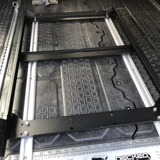

There is no snagging. The Yakima rails that decked sells line up with divets on the decked platform that go into the metal cross rails beneath platform. Using the square yakima nuts I then mounted the Alu-Cab fridge slide to the rails with stainless allen head bolts. There is no compromise to the waterproofness or function of the decked system. I cut the rails down also. If you cut them, make sure to mark them and match up properly to decked platform. IMG_6308.jpeg

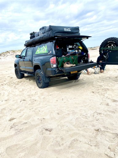

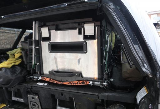

Place it as far to the end of the topper as you can..make sure you have enough room on the tilt. Half an inch away from the decked cubby for clearance

What’s the height on the fridge. The reason I got this set was because of the clearance. My friend and fellow third gen taco owner made his own.. you need to see it.. definitely a machinist in his craft.. no welding either..

It's right around 19 inches high and I think I have about 22 inches of clearance ant my lowest point with the decked platform installed. I ordered some t track and I'm going to install the dometic slide for now but, without it being able to drop down or tilt, I think it's going to be a little awkward.
