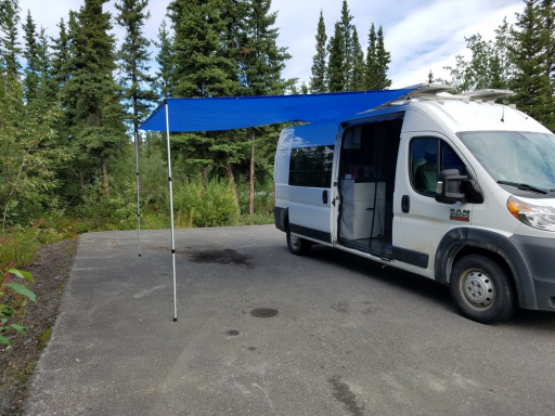

i just did a cargo trailer conversion and im just going to go with a blue FEMA tarp...we get a LOT of hurricane damage down here and i swear there are blue tarp roofs that have been up for the last 10 years. rhino batwing awnings can suck it....

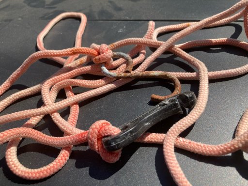

Put my batwing up last weekend so the kids could roast some marshmallows over our propane fire pit camping in the side yard. This is not a complaint, more of an update on longevity. I installed my batwing in 2016 and it’s at well over 200 nights camped/deployed at this point some of which were in absolute horrid conditions. The factory guy-lines are about toast. They aren’t mechanically failing but the nylon jackets have given up the ghost to UV exposure and are now leaving white dust everywhere when the tarp is pitched. I’m evaluating replacement options now. May be some retired 6mm static utility line I have around.

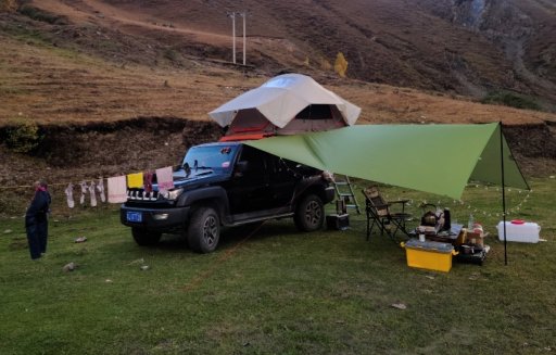

Shelter is the most important issue for me and I've looked at all options out there for mounted set-ups. In the end nothing beats a nylon tarp with good grommets...as well as suction cup anchors that can be installed anywhere on the vehicle. That is in my humble opinion of course ;-)
Many times the area around the truck has been limited so deploying an awning would be impossible, regardless of what side you want to protect. Mountain camps can have winds whip up without a moments notice and create havoc no matter what you have going, and I've come across many who have had their awnings almost destroyed because of this. Also, catching water is paramount for us at times and a tarp allows for full use of the area.

Look up Blue water ropes. UV light is what kills rope, polyester and spectra are less subject to it but some polys are stretchy. I use nylon and replace every few years.
Oh I’m familiar with UV breaking down ropes, but under a year worth of intermittent use shouldn’t generally deteriorate the jacket to this extent. Heck if falls don’t retire our BW 2 11mm rescue ropes early we generally hit the ten year mark and retire them due to age. I use BW 3mm niteline on all my other tarps years ago and some of them are approaching 20 years in service with nary a concern about the tie out lines. Generally in my experience the seams/fabric of a nylon tarp itself will give up before my guy-lines need replacing.
