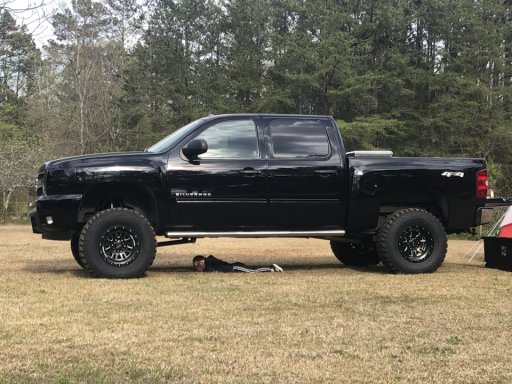

Definitely regear, I had 35x12.50r17 on my old 2011 sierra 5.3/6speed 3.42's and regretted it. Definitely needed more gearing. I won't put 35's under my 17 sierra unless I regear it.

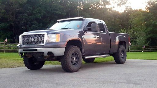

I drove it daily. It had get up and go when at speed to merge onto the highway and stuff but was a dog when taking off from a stop or climbing hills. But I cleared 35's on that 11 with 2.5 level and 1.25 body lift . The truck looked amazing, got lots of compliments on it.1552321385205_20170729_212053.jpeg
I drove it daily. It had get up and go when at speed to merge onto the highway and stuff but was a dog when taking off from a stop or climbing hills. But I cleared 35's on that 11 with 2.5 level and 1.25 body lift . The truck looked amazing, got lots of compliments on it.View attachment 88977
That is a sharp looking truck. They look so good lifted. [emoji1303]

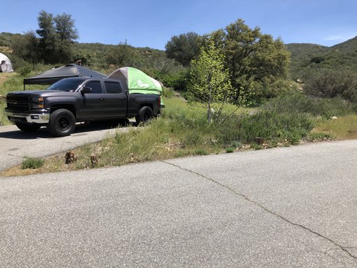

Here is my truck 14 Silverado 1500 4x4
Has Camburg upper arms
2.5” Kings. (Truck is lifted 2.5” up front)
17” methods
315/70/17 falken wildpeaks at3w
I trimmed the inner fender well a bit, just the carpeted areas. I still rub barely on full lock. Doesn’t bother me and doesn’t hurt the tires at all

Nice truck!

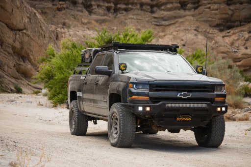

Alright everyone, Finally did it! Here are the details.
3.5" lift
35" BFG KO2 12.5 wide
Replaced from bumper with Westin automotive Promod bumper
Norcal Cut the back of front wheel wells. (added about 1.5" of clearance and did it clean so it looks factory when plactic is put back on)
didn't regear as I have the tow package on my truck with 3.73 gears. Its pushing my luck but handing it fine. 104608

Looks awesome! I love how you fit 35s and it doesn't look overly tall and top heavy. I plan on purchasing a crewcab Silverado as well when I start my build and I was thinking 33s would be the biggest I'd go because I didn't want to have to lift it too much. But this is making me rethink that. Can't wait to see it on youtube!
I also wish that Westin auto (or anyone else) made bumpers like that for the 99-07 Silverado because that'll be the model that I'm getting

Thank you! ya that was my goal, keep it as low as possible and as big as tires as possible. The silverados are def neglected when it comes to aftermarket parts. good luck with the build!
