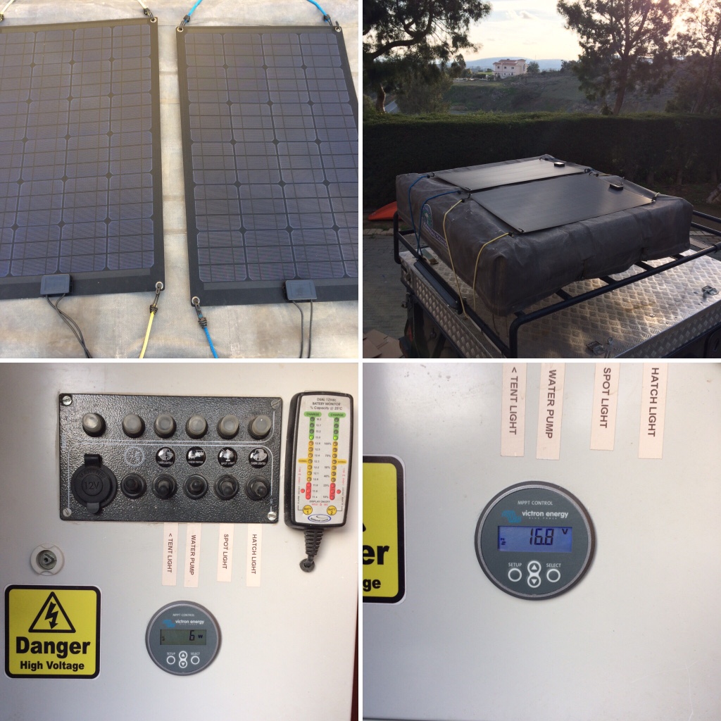

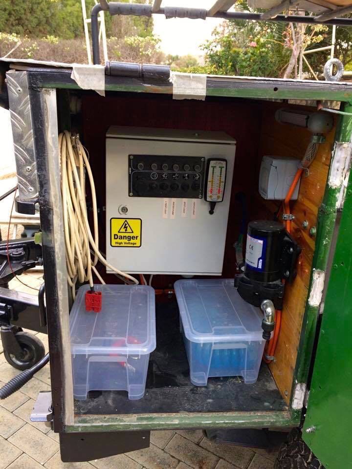

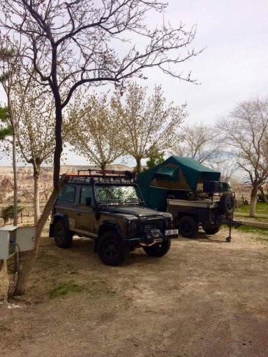

Yes I have dual 100ah batteries and the electronics box holds the mppt solar controller, mains battery charger and switches / fuses.
2 x flexible 60w solar panels can be mounted when the tent is packed and whilst driving.
All that feeds the LED lights, tent electrics and the high capacity water pump.
My fridge is in the Defender and can be run off the aux battery there or connected to the trailer batteries if needed.
It's taken a bit of trial and error to get it how I wanted it but happy with it now.

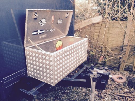

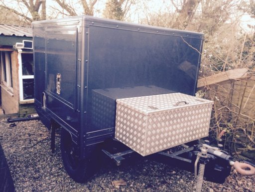

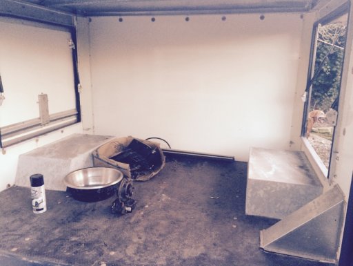

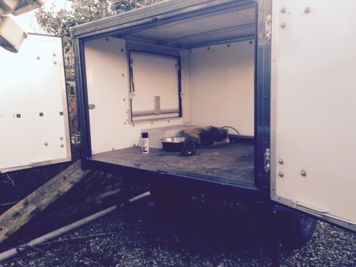

i am fitting a draw system front to half way and draws open out of the side doors, my electric will be on the front bulk head in its own. Aluminuim cuboard space , my calorgas in the box i fixed on the front behind the tow bar , i am not sure on the load bearing capabiltiy of the box yet for Rtt and solar
All on paper at the momen but as its up next to my work shop its playing on my mind
Now after seeing yours , did you just build you power system or Is it a kit have been looking at a few . My electrical skills are 0 so ill be getting a auto sparky in to do it .

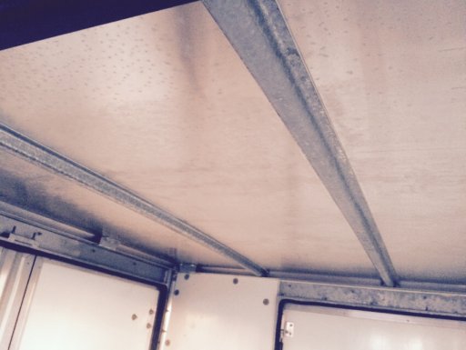

Didnt mean to hi jack your thred polly just pictures speak louder some times , And glad i went outto take them as i notised a manufactures plate up behind the rear doors ill ring them to check out roof loading spec tomorrow

This is a really cool setup. The trailer and rig look like they were made to go together.

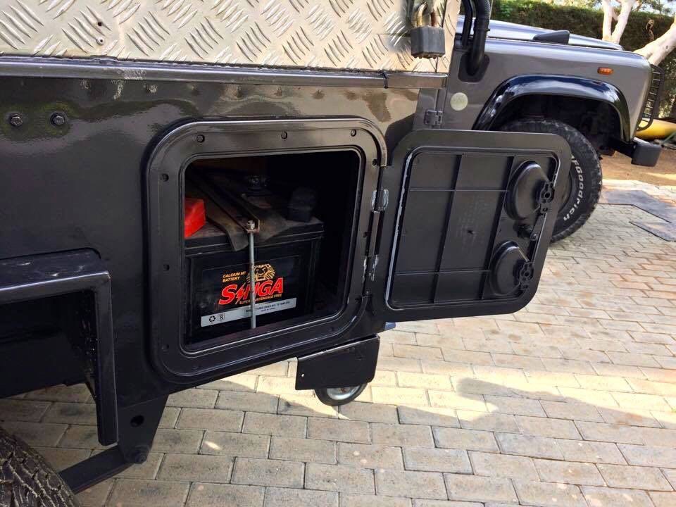

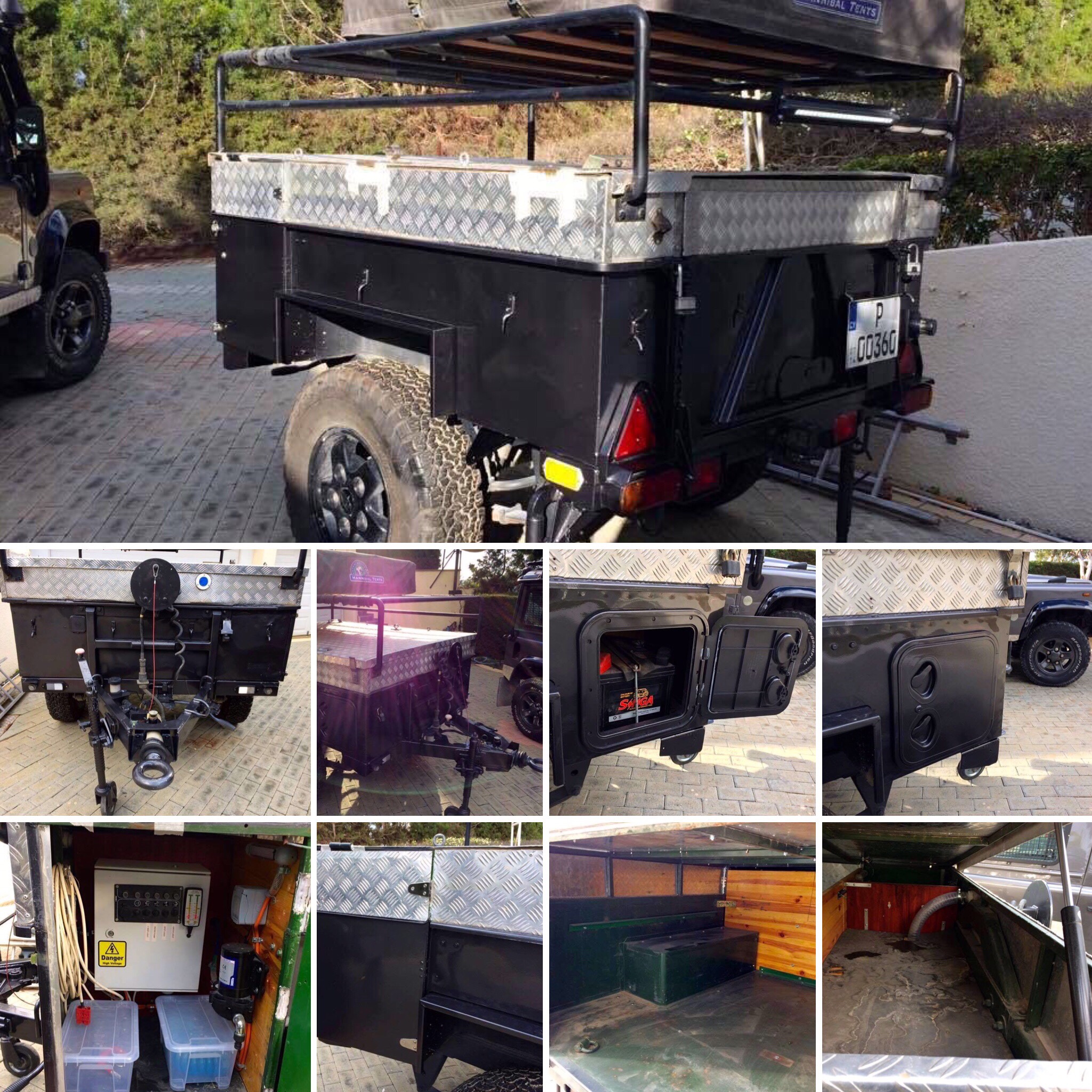

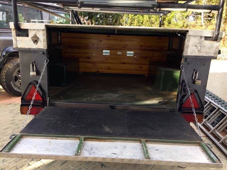

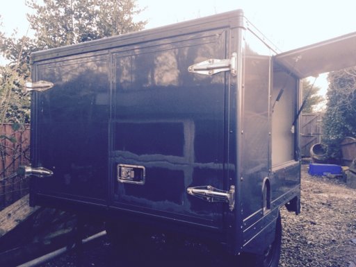

The trailer is ex military British Army designed specifically to be pulled by a Land Rover.
All I have done is raised the height slightly and added a custom rack to take the Hannibal roof tent.
Internally I have added a water tank pump and electrics for led lights, sockets and a battery compartment for 2 x 100ah batteries. I also added mains and solar hook up.
Then had the trailer repeated to bonatti grey to match the tomb raider defender.
It has taken a while and a bit if trial and error but I'm happy with it hence we are now in Turkey in the first week of our 12 month trip from Cyprus, North Cyprus, Turkey, Europe, Scandinavia, UK and then maybe on to Africa.
Pictures are from Cappadocia, Goreme in Turkey.
