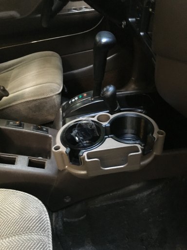

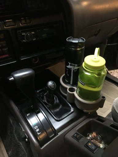

So one of the first upgrades I did was install this cup holder from BH3D printing that my mother-in-law purchased off of Etsy.

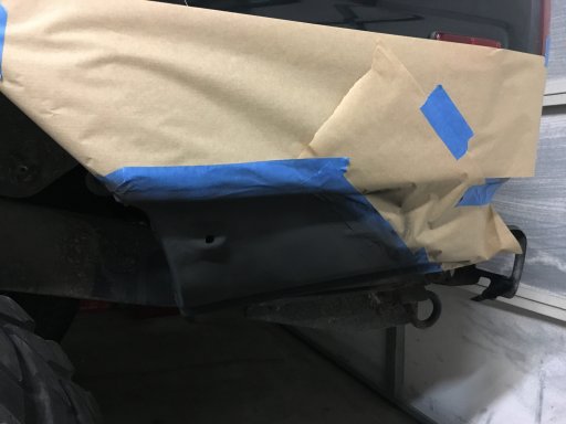

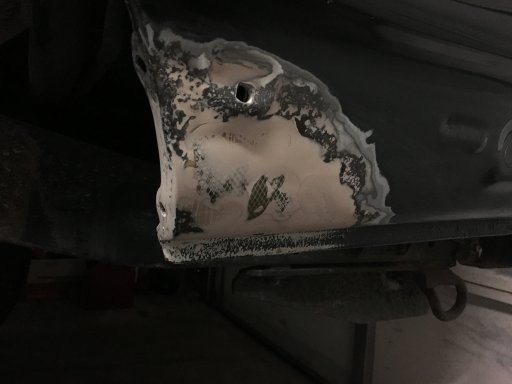

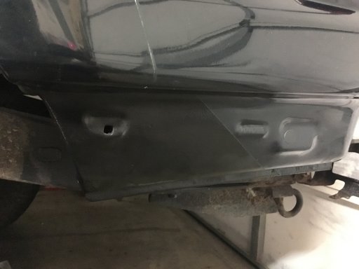

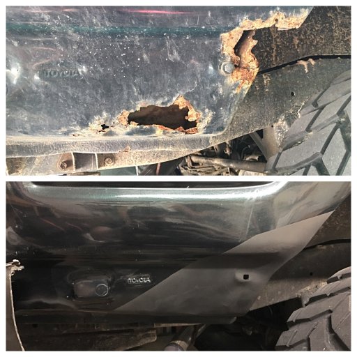

Next, I repaired a rust hole that was above the exhaust pipe on the lower quarter panel. (Top, before: Bottom, after).
For never having worked with fiberglass or bondo, I feel it turned out well. I reinforced the holes with wire mesh which will hopefully provide it with sufficient rigidity and strength. I would love to add welding to my skill set, but that will have to come at a later time.

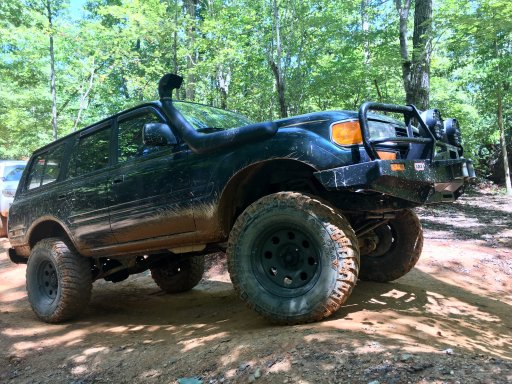

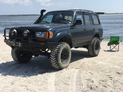

I'll end this post with one of the first trips we took with the Cruiser. We loaded up the family (including grandparents and the pup) and headed out for a beach day at Top Sail, NC.
(I eventually turned the top of the snorkel around so that it was facing the correct direction. The previous owner had it positioned that way to "avoid rain water," which I learned is unnecessary.)

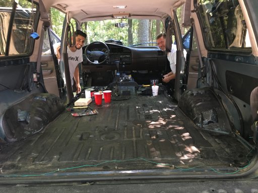

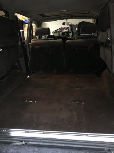

The next upgrade, was installing carpet. The previous owner had removed the carpet and sprayed down bedliner. Wanting comfort over function we decided to reinstall the carpet. Below you'll see before and after pictures with the seats removed. I forgot to take a picture of this step, but prior to putting down the carpet we lined the whole floorboard with Noico 80 mil sound deadening mat. Made a huge difference with road noise, and has seemed to help keep some of the engine heat out as well.
Brother- and father-in-law helping me out with the install.
(I'm curious if anyone could post a pic of the factory carpet install. I'm wondering how Toyota hid this seam (see above) between the front and rear pieces of carpet. Maybe the original carpet was all one piece? Or maybe there's a plastic trim piece that I'm missing? The seam is not as noticeable once the seats are in as you can see in the next picture.)
With the seats back in.
Feels like a brand new car!
-JCruise

Next, I patched the matching rust hole on the left rear quarter panel (that I accidentally discovered by pushing my hand through from the inside of the truck). I eventually figured out (a few months later) that the trim pieces under the rear sliding windows have small gaskets that eventually fail and then water begins to pool in the rear quarter panels...thus the matching rust holes.
I used fiberglass, steel mesh, and bondo to patch the hole.

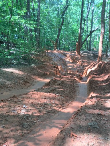

All the rain made for good muddin' at Uwharrie.

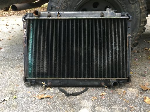

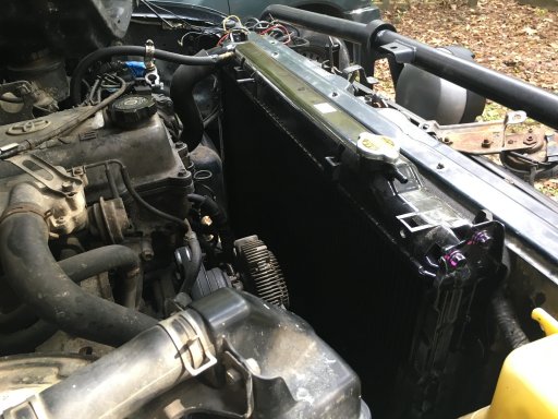

On our way back from Uwharrie Natl. Forest, I noticed that the radiator was about on it's last legs. When I got home I ordered a replacement OEM radiator of the ol' interwebs and had it shipped home.
Later that week my wife was driving the cruiser as her car was in getting a new starter installed. Something that I learned is somewhat common in Honda Civics. We had had the civic towed in the morning to the dealer and my wife was out running errands in the cruiser with the little one.
It was pouring down rain, and of course that's when the radiator decided to breathe it's last breath. A big billowing breath of white smoke coming from under the hood. My wife called me in a panic, while I was at work and I instructed her to pull over as soon as she could when it was safe. She made it to the bank parking lot.
I met her in the parking lot, along with the same tow truck driver that had towed our civic in the morning. He was more than happy to help and got the cruiser home safely. All in the pouring rain. A quick switch of the car seat, a trip to the Honda dealer to pick up the civic, and we were able to get all cars home safely. I'm glad we have AAA and USAA.
That next weekend, the radiator arrived and I was able to swap it out.
New radiator.
Getting the fan and fan shroud back in was awesome fun. They put extra radiator fins in right?!

Nice build so far! I’ve got a 93 and a lot of baselining to do as soon as my old rig sells. If you haven’t checked ih8mud.com for the forum resources for landcruisers, I strongly recommend it. Community is very knowledgeable and friendly.
For that seem there’s several small studs in the floor that pop into plastic rivnuts in the cargo section. Basically the front section goes down first and the rear section secured them both. I don’t recall there being a trim piece on top, but I’ll check when I get home.
I know this is coming a few days late, but the factory coolant hoses tend to rot from the inside and not show much, if any, wear on the exterior before they fail. Same with the heater control valve. All hoses and the control valve are available through Absolute Wits End. Lots of other products designed for landcruisers by land cruiser owners on there as well!
Thanks for the reply. I look up stuff on ih8mudd frequently. It’s a huge time saver.
Regarding the seam, I’ll have to check if I layered the carpet correctly. I did notice the small studs poking up from the floor boards. The carpet I purchased has rubber backing and with both layers I do not feel the studs will reach through the carpet to grab onto anything meaningful. Any idea where I may be able to purchase those small plastic nuts if I decide to install those?
Thanks for the insight on the hoses. When I changed out the radiator I had a thought to switch those out as well but I was impatient. Hopefully I don’t pay for that later. :). I’ll check out that website for sure and prob order the hoses for when I have some extra time on a weekend.
