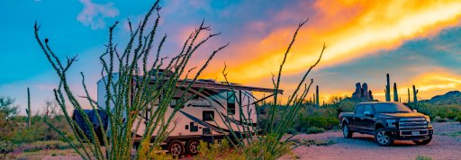

Apologies for the long post, but I wanted to give enough context for some meaningful responses. Many thanks in advance! Here's a gratuitous photo of our truck and trailer for reference.
