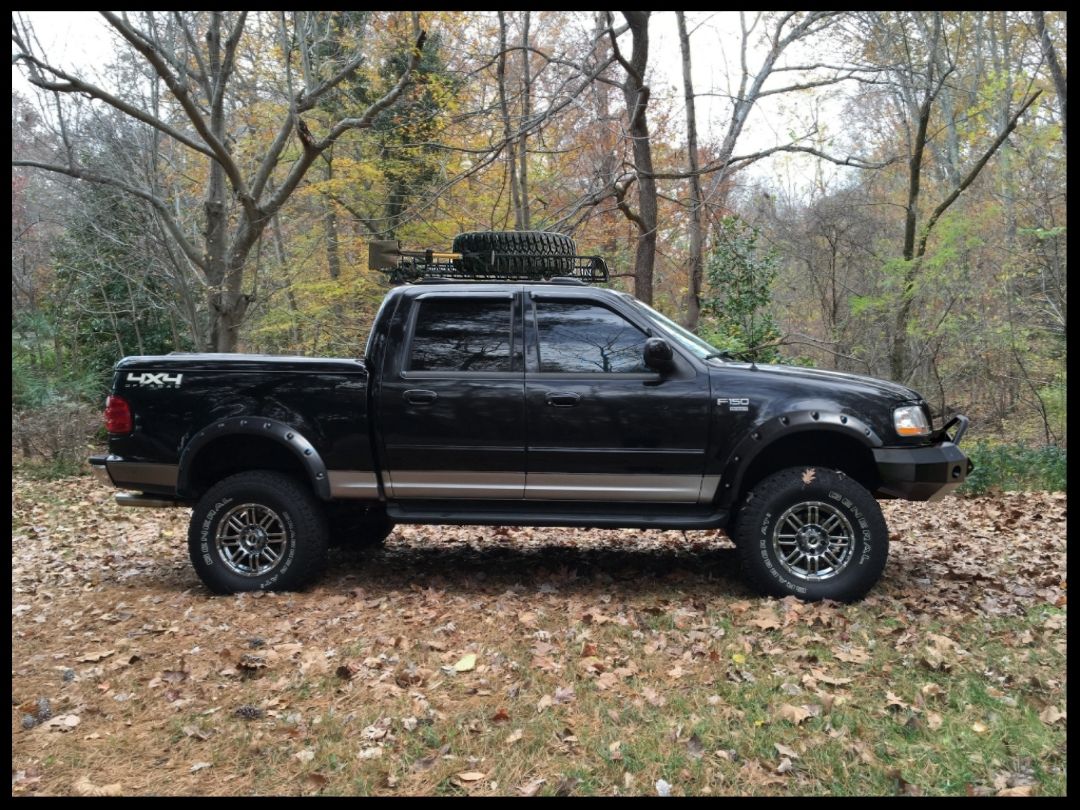

I usually am not a Ford man, but, I have to say, yours is pretty damn sharp man!
What kind of future upgrades you planning?

There's not much going on right now. I took the "winter mode" tonneau cover back off permanently. It seemed like it was getting in the way more than it helped.
I ordered those flares in the last picture and everything for my E-Fan conversion. I still haven't installed the hood vent since it's winter time and it's not really needed yet. ..although it was 72* out today, lol.
I don't really have any plans for the winter. (except driving it and of course installing the e-fan this week.)

The stock engine has 260 hp @ 4,500 rpm & 350 lb-ft @ 2,500 rpm (flywheel) which is fine for lugging around the truck on the trails but it's in dire need when hauling a trailer through the mountains. Even with 4.56 gears it's still not enough power. There's about 100k on this engine which means it still has plenty of life but swapping to a high compression 4 valve navigator engine with B heads or a Lightning engine with a stock Eaton supercharger would give me everything I need, more and be completely reliable for another 200k+ miles.
