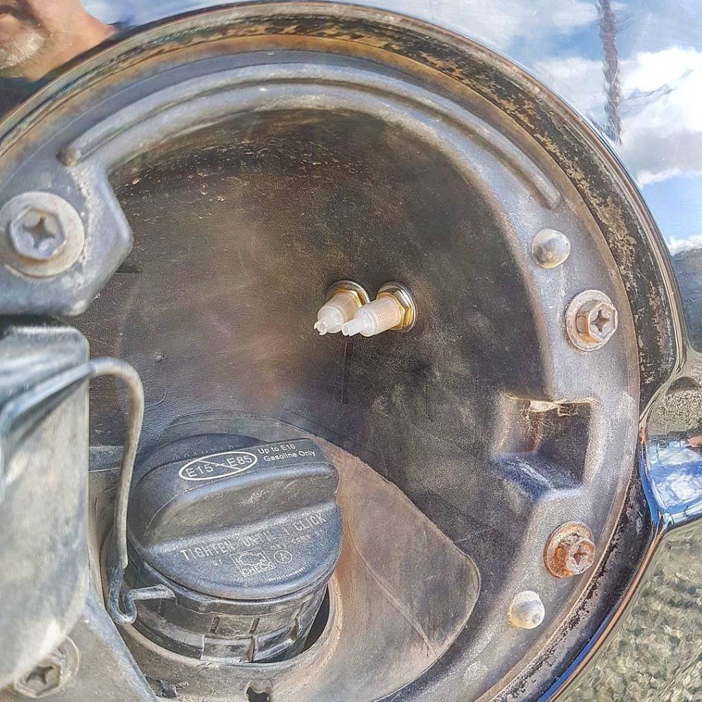

Installed the Firestone airbags today. Was a pretty easy install. I had bolted in the lower Daystar cradles last weekend. I ran the air valves into the fuel filler pocket.

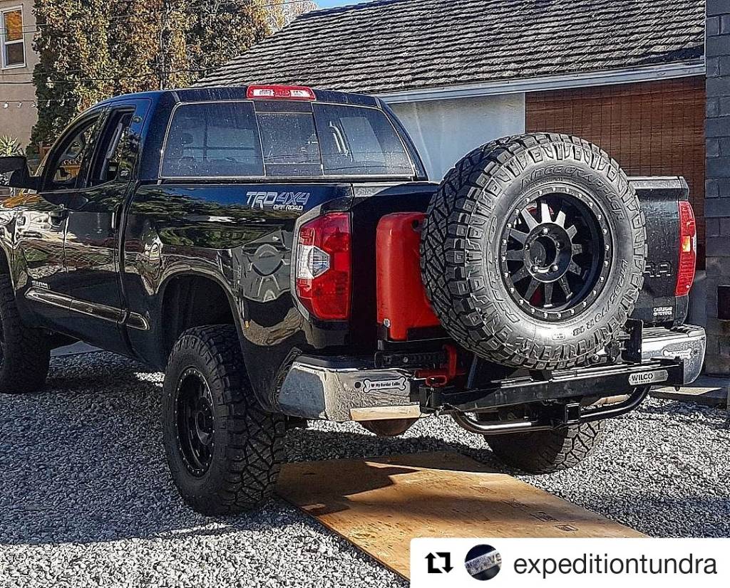

Well, I got the call from my US drop ship place just across the line that my Hitchgate has arrived. I love good news. Heading down Wednesday to pick it up. Also have a new backup camera to pick up as well.

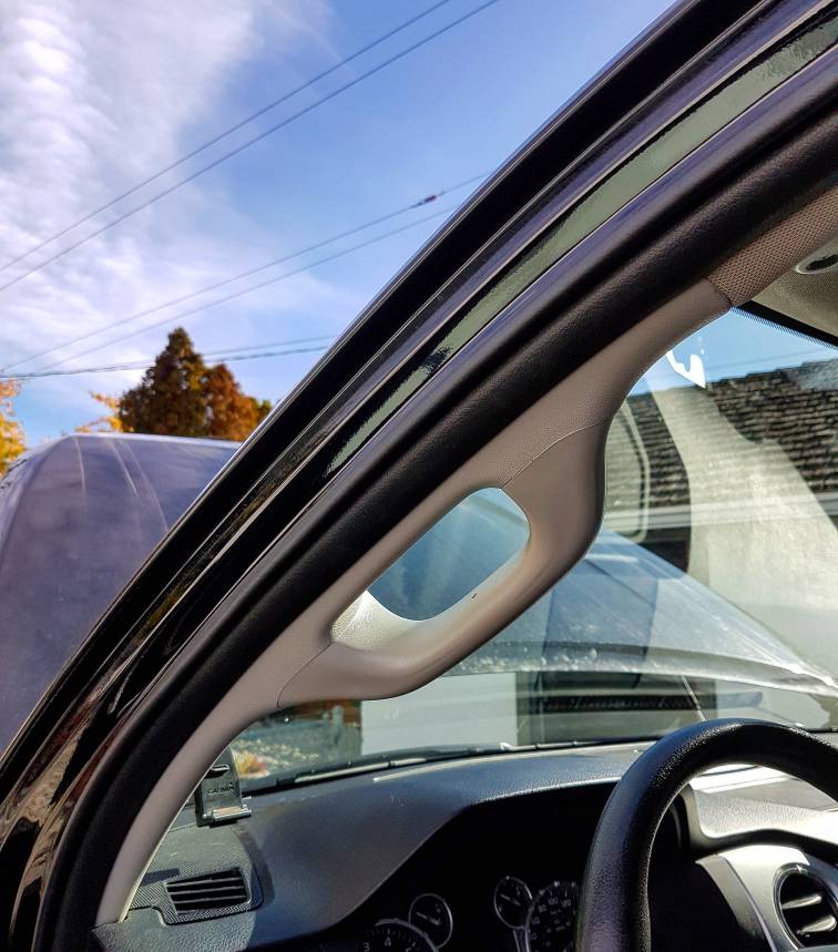

Did a couple things today. A very simple and quick mod first; addition of a driver's side grab handle. Don't know why Toyota decided to scrap this year's ago, its a great addition, especially for my vertically challenged Wife.

Amazing progress! How’s the gapping between the tire gate and the tail gate?
Adequate room it seems. A few inches between the fuel cans and the tailgate. There are 2 positions to mount it I the receiver, and I tried the closer one. The second would space it further away by an inch or two.
