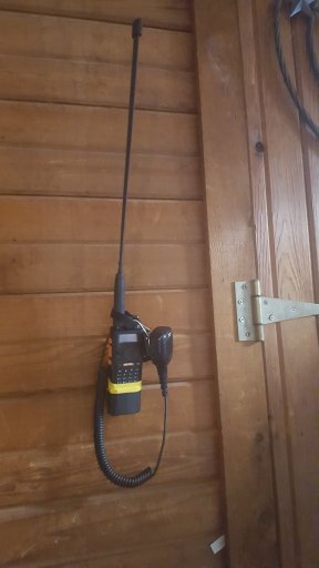

I use a baofeng uv5rex, turned it into a base station. Extended battery lasts around 3 days, longer folding antenna and hand mic make it easier to use in the vehicle. 5 watts will get you in the game you can talk up to 26 miles and even furter with repeaters honestly though baofengs are more like 10 watt especially older ones.
If you wamt to have the ability to talk further or do skip then a high power unit is needed. Mine has done everything i want, normally its being used as a police, ems scanner. I plan on eventually getting a in vehicle base unit so when spotting for my wife one of us dont have to use a old uniden gmrs/frs radio that eats batteries like crazy.
I've tested a few of the Baofeng radios with a power meter and dummy load and have yet to have one put out rated power. The closest I've gotten is 4.5W with my UV-5RA and a friend's "8 Watt" version put out about 7 watts max.
Have you tried with the extended bl5l battery the bl original battery sucks. Or even the 12v battery eliminator. I really dont see why everyone needs such high power none of my overlanding needs has called for being in contact with someone more than 5 miles away. I guess if your going to get deep into ham and do the national meet up stuff, doing civil defense or your tying to talk with aliens. But just keying in to say turn here or dont turn there we could all easily get by with citizen band. At this very moment im listening to a sherrifs office dispatch 40 miles from me on the little low power baofeng.
With all three of the batteries they had at the time for the UV series radios. I don't have the eliminator.
