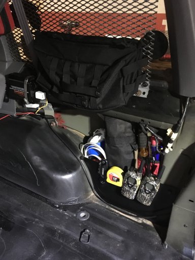

I’m sure most of y’all with small vehicles have space issues. On my 98 XJ I have 0 space for two separate batteries so I was going to try an Odyssey or Northstar dual purpose battery which do y’all prefer?
No info on the battery but as far as space is concerned I have seen some mods made to put a second battery in the little useless space on the passenger side in the back. It was on one of the cherokee forums. It required reworking the whole panel but seemed to be a better use of the space. I cannot remember if it had a lead to the alternator, though that seems a bit of a run. Setting up a solar to something built in there would not be too complicated.

Yeah I think I know what area your talking about and it’s already taken lol IMG_0600.JPG
