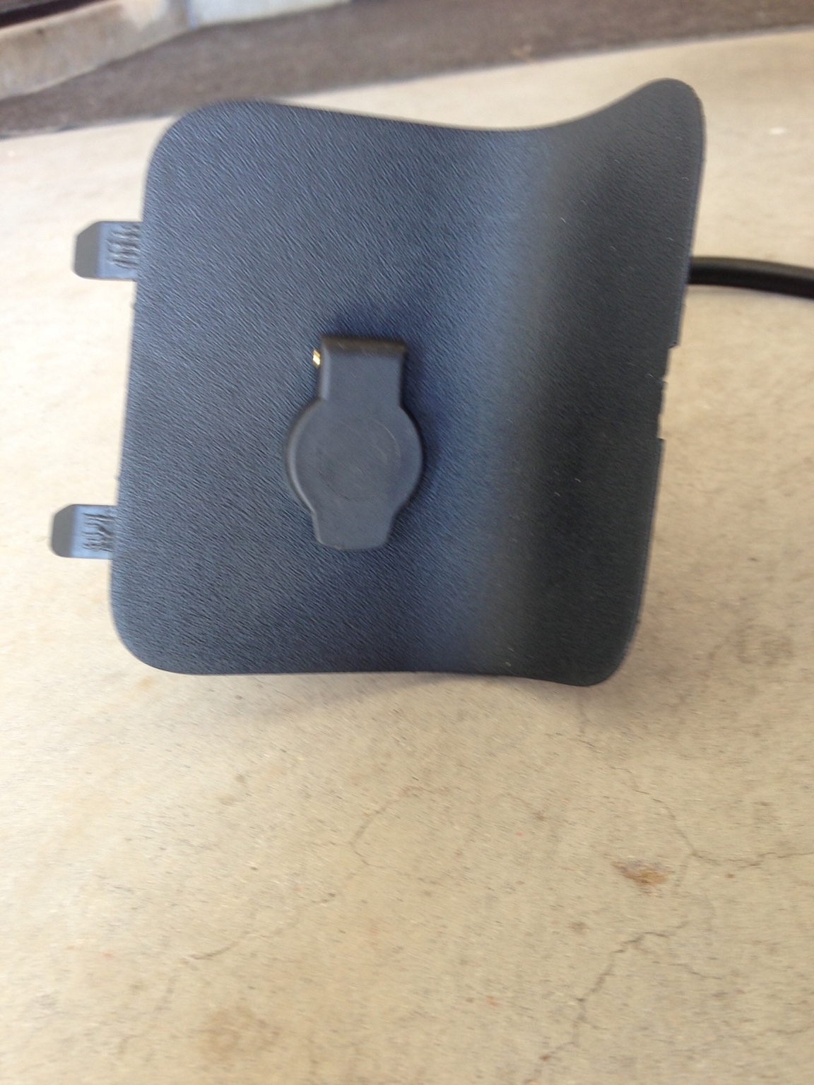

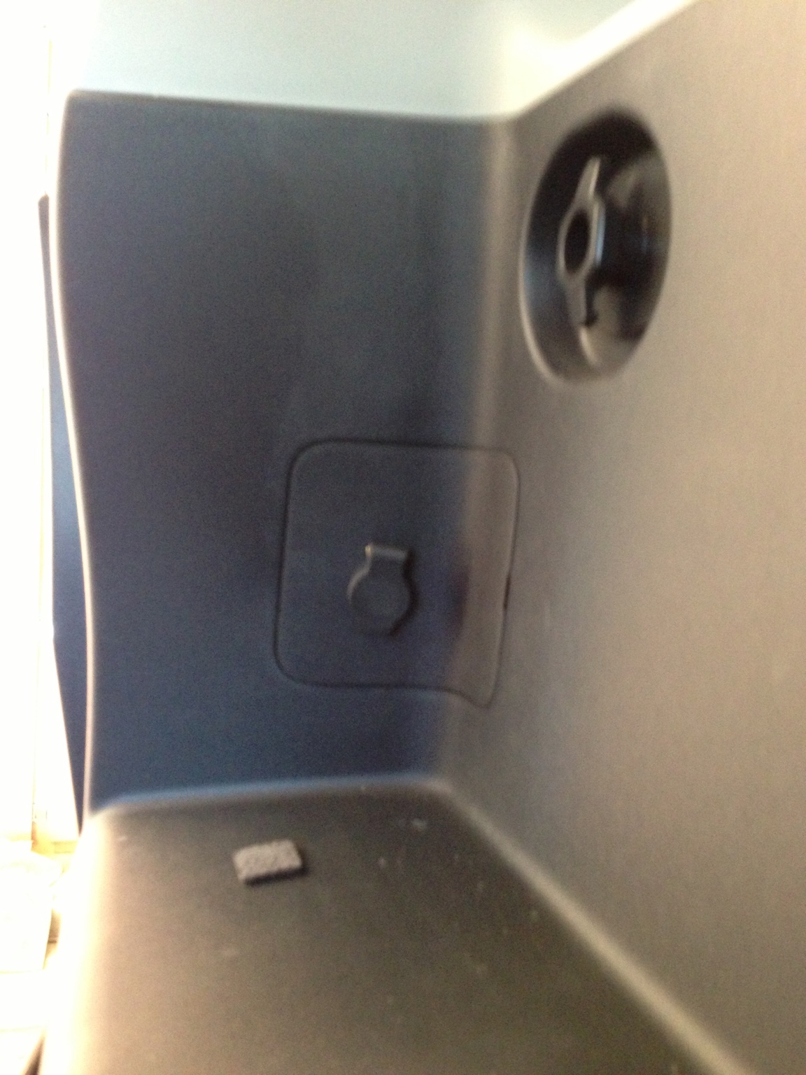

Here are a few pics from my original install.

Not sure what you are referring to. The ARB wiring harness is dumb. All it does is provide an easy way to put a plug in the back of your vehicle that is always on. While I hate to bounce out to another forum or thread I think this is a good time to do so. We are getting too specific to one type of vehicle. Not sure where you are getting all of your voltage info from. Odyssey batteries tend to have very specific charging profiles. Other than that brand I'm not sure what you are referring to. Not all AGM batteries need to be charged up to 14.8.

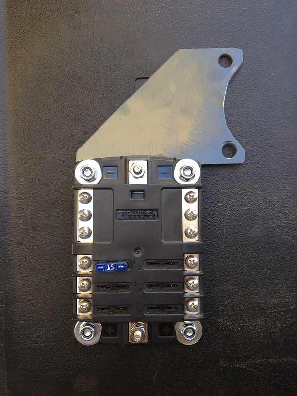

This is an old photo with my dual battery setup. Now removed. I built this diy controller box so my setup could be portable. It was originally used with a panel that didn't have a built in controller.
If you mean fuse block it is mounted by my brake pedal in the FJ with large gauge wires going through the firewall to may battery. I only have one battery these days.
