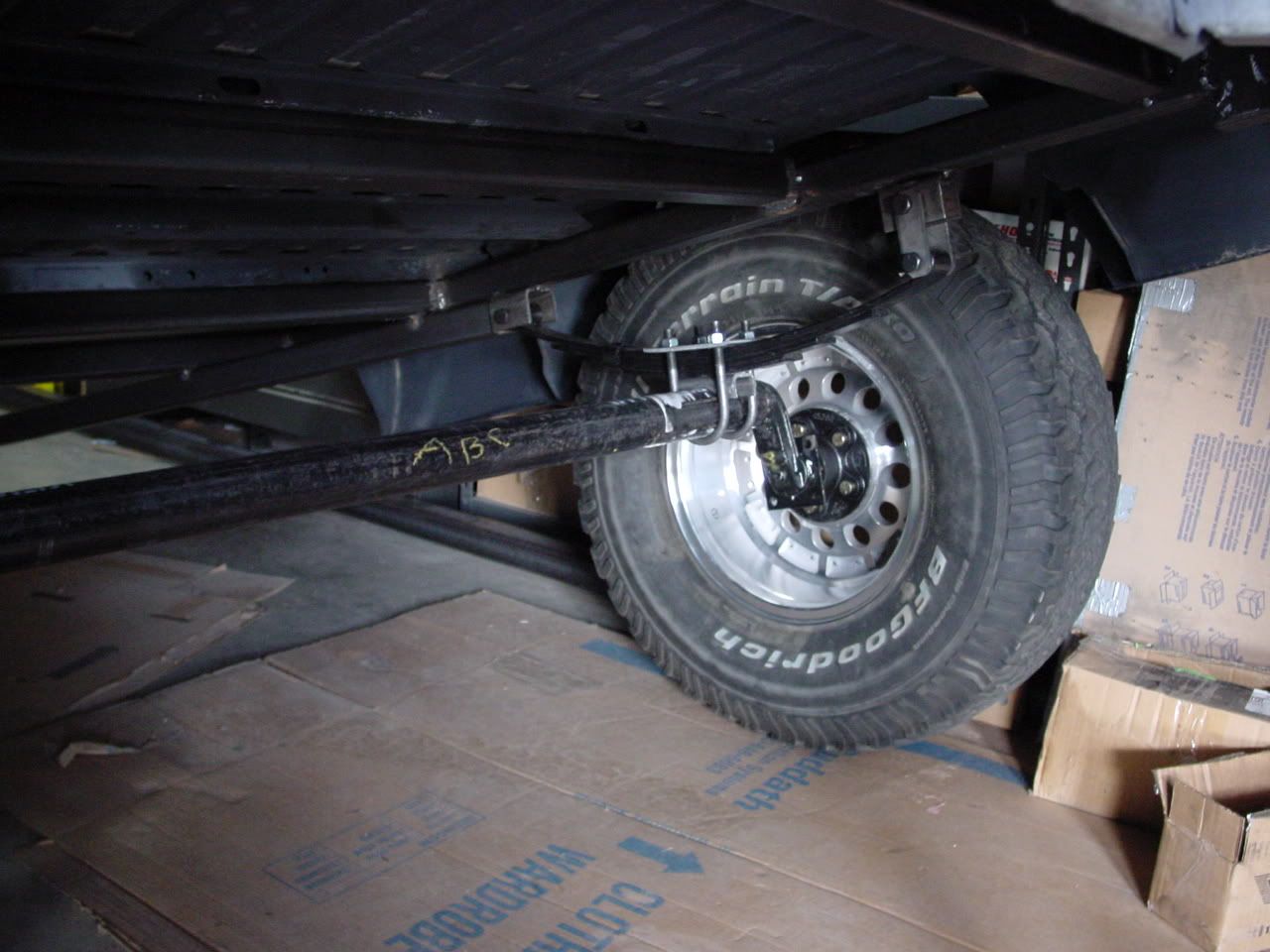

This is similar to what I was thinking:
I found a good explanation about it here. This is the quote:
I think that it's viable, but within a small set of conditions. The now lift distance is going to put a large leverage on the spring perch and leaf springs. Any hard hits to the tire tread will be magnified at the spring.
Another issue is if there is camber in the axle. Some drop axles have camber built into them to offset flex under normal loading. If the axle chosen has this feature then the camber will be wrong when flipped over, and it will only get worse as the load on the axle increases.
So if there is no camber in the axle chosen and the roads that the trailer will be towed on are smooth then I think it's viable. As the road condition worsens the loads on the spring perches, U-Bolts, and springs themselves will increase. Where the failure point is I don't know, but I would expect it to be not too far out there.

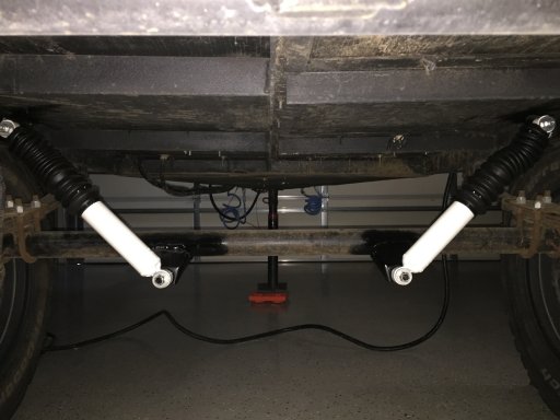

Mine looks as your picture. Not sure what you call it. Can kind of see it in this picture. I would put shocks in it. I had a little sway when I hit large bumps at highway speed. This shock set up stopped that.
