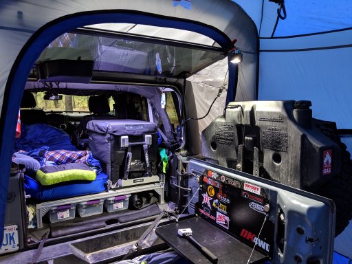

An update! So I've had the fridge for about a year. I've camped and day-tripped with it and it's covered many miles with me in 2 countries. And it's now ~ permanently installed in my jeep (which, is still my daily driver), so I've used it both for adventuring and for every day things. I still love it.
This was from camping last October (Canadian Thanksgiving weekend):
So the fridge is installed on a slider on the DIY platform I've built (separate build thread coming eventually). It slides out nicely clearing the support wires for the tailgate table. It sits a bit high, but it works alright for me. I can't get the basket out in this configuration because the lid doesn't open all the way, but I can get the divider out, which is sufficient.
From my original post, I've solved 2 of the 3 nits with the setup using adhesive velcro:
- The extra velcro around the lid that makes it hard to open quickly, I've simply covered those velcro areas with adhesive velcro with the adhesive backing not exposed. So now it's not grabby and thus slides open. The insulated cover still closes snugly and stays put.
- I put a strip of adhesive velcro 1/3 of the way down the lid just beyond the latch handle and attached the lid there. Now the cover lid doesn't flop behind the fridge!
Just need a strut or leg, or something to hold the lid open for those occasions when needed. Alternatively, a side-opening lid option for this fridge would work even better.
