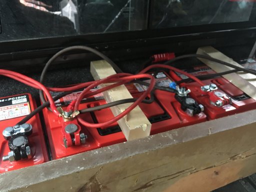

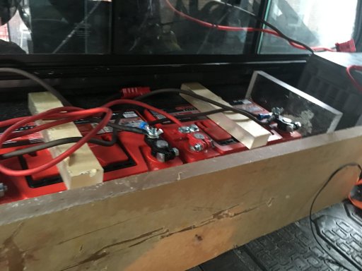

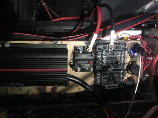

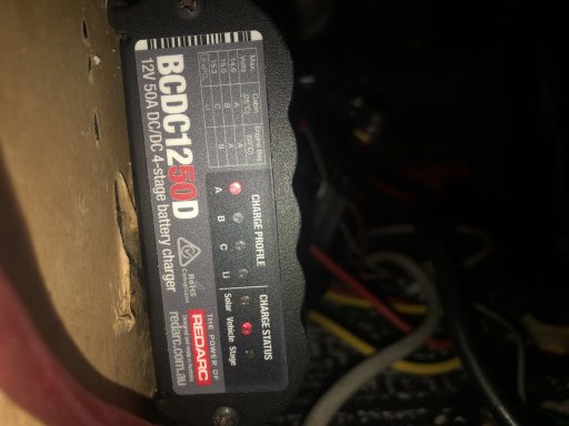

So I decided on going go dyi system using a red arc BCDC 1250 d and a thermoware monitoring unit instead. The odyssey group 31 in series. 4A0A28A6-2B03-4EB4-893E-CC743BD88032.jpeg91FA0945-FD11-454B-BAC4-A330C56768DF.jpegEE4290CC-D7FC-4578-BC09-4FA1F7FEC82A.jpeg0CBF90CB-42F2-46EA-855E-5584010753FB.jpegB38BBA08-BD98-4A61-8F84-CE7671BFA1A4.jpegEC6FC341-C4CB-4B4A-A804-2FE8FE77180B.jpeg4913A374-9AFA-4464-94CF-4E88A314FF0F.jpeg
With an additional unigi battery just just in case. 93597FFF-3CE7-414F-B733-0578934D1C22.png
Just case the solar is not getting any sun, the crank battery also odyssey group 31 and stock alternator can supplement while Iam driving..
