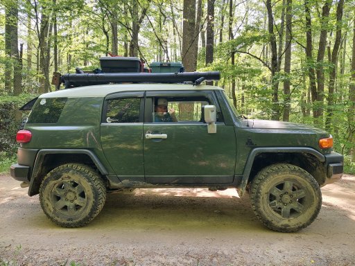

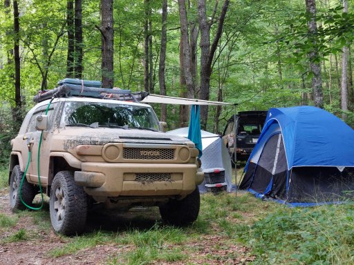

I made a pipe with 4 inch PVC pipe that I mounted to my roof rack. I added outdoor hose attachments to it on one end. Not pressurized at the moment but did purchase the parts to do so after using it on this last trip and getting tired of the super low pressure of the water flow. It;s fine for washing dishes but not so great when showering. I can make up a parts list of what I used if this is what you were looking for. Here are two old pics from 2019 when I built it. Both ends have been changed a bit. The front it now straight with an end cap and fill hole is on top. The rear I redid to a 90 degree which puts the output on the side, but now that I'll be pressurizing it I will be using another 45 degree possibly attached to the 90 at some point depending on where it drops down to. Or 45 alone just shorter so it doesn't hang off the back of the truck and interfere with the rear hatch.View attachment 199739View attachment 199740

I made mine out of 4" PVC. It has a fill/pressurize cap on one end and a hose attachment on the other. Used it this past weekend and it was nice to have a warm shower after riding all day. The whole thing was maybe $50-$60. Everything came from Lowe's. I had to use white PVC because they didn't have black in 4", but covered it in black truck bed liner.
I can take some closeup shots of it if you like so you can see the parts you will need and how it all goes together.

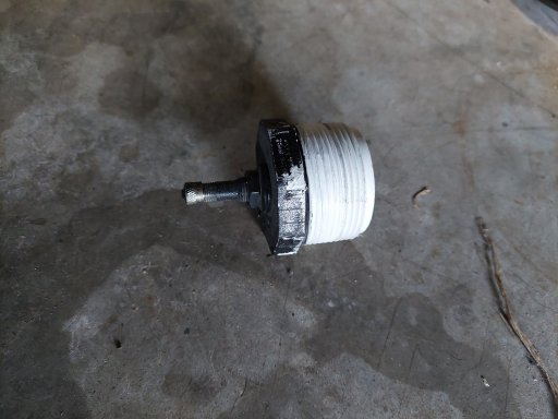

I like how your's looks!! I have two questions as I'm about to redo my exit end. What parts did you use to come out of the PVC on the endcap? I have had issues with mine having a slow leak. 2nd Did you put the pressure stem on a removable cap on the filler side? I was going to put mine somewhere on the exit end when I redo it, not sure if it's better to put it on the other end. Thanx in advance. -Jon-
Just re-read your post and see you said it's on a cap. sorry.....

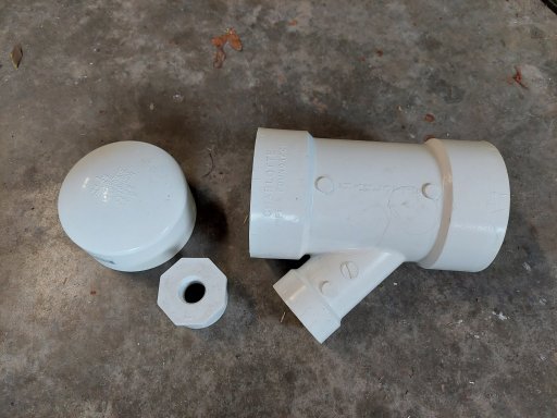

Here are some closer pics of the parts and ends.
Mine holds pressure pretty well. I will pump it up to 25psi and it lasts longer than I need it for a shower or whatever.
I have a small bicycle hand pump that I carry with me and pump it before I use it.
