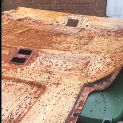

As you can see from the picture most of the remaining headliner had been screwed up as the glue holding the fabric to the trim had failed long ago..
I set about removing all the side panel trims to allow me to remove the roof liner, not a hard job just dirty and smelly as it’s probably the first time in 24 years that anyone has shown any kind of respect to this poor thing :(
Once removed I had to then remove the old rotten fabric and clean up the roof liner trim ready to accept the new fabric. This was not a nice job, scraping and scrubbing the old glue off the trim, I found the best way was to use a wire brush, anything else just clogged and was useless

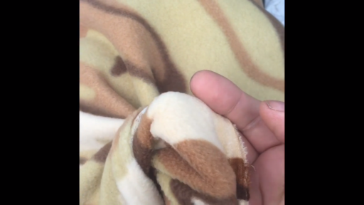

So once I’d cleaned up the trim it was then time to glue new fabric on. I’d chose a fleece fabric as it would stretch to the contours of the roof, the design may not be to everyone’s taste but it fits in with the finished plans for the truck.. and it’s cool as polar bears toe nails:tearsofjoy:

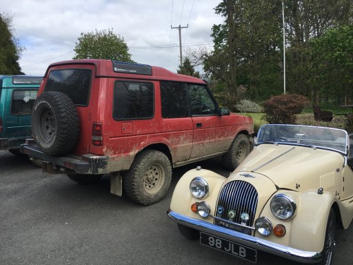

Since I bought the Disco I’d been speaking to a few guys on Facebook about green laning (off roading to the rest of the world) and was planning my first trip out into the hills of derbyshire.
I was quite apprehensive about this as I’d littlerally done nothing to the chassis and running gear since I’d picked it up.. I knew from stories how harsh it could be! But none the less we went out and had an awesome day, I was instantly hooked :) and was amazed at just how capable my little red Discovery was.
It managed the terrain effortlessly and that was pretty much standard apart from some worn mud tyres.
One thing I did notice though was that it needed a lift as the rear suspension kept bottoming out and the arches would rub on any kind of articulation.
So once we were back home I ordered a terrafirma +2” lift kit which consisted of a set of uprated, stronger dampers and medium duty +2” springs for all four corners.
Off to the workshop to fit them and WOW what a difference, it was a total transformation, the old suspension must have been very worn because now the ride, handling and noise where so much better.. it was almost like getting out of an old clapped out London black cab and getting into a new BMW! The difference was that great.
