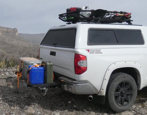

I didn't do this for the sake of bears, but having a swing away hitch mounted rack/basket might be something useful to you. when we travel with the pickup only, I forego the 12v fridges we have and go with a regular ice chest on the back. gives more room and kind of perfect to swing it over and cook off the tailgate with the ice chest right there. might could buy a cover for the 12v fridge and run a cord to it if you rather the 12v one. also a very nice way to carry extra fuel without fumes inside the shell. just an idea...
otherwise i'd go with the cooler in the back seat. should have an easy access to 12v socket and between the ice chest seal and the cab seals...I doubt it would smell enough to attract bears. if we sleep in the back, then its also nice to keep the back clear so that when we pull off somewhere to sleep, its dark and maybe raining, so the last thing I want to do is be moving stuff out of the back to the cab of the truck.
I also went with a basket on top, so there is extra room for totes of clothes and stuff up there and frees up the back seat more for the chest if you go that route. I also keep the LP tank up on the roof and run a hose down to water heater and stove. Don't want to sleep with LP tank in the shell with me.

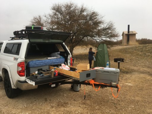

I have all my food/fridge in pull out drawers in the bed. Although I have not traveled west yet (Aug2026 is a go). In the multiple trips I have been on, I have not experienced bear issues in the Smokies or Blue Ridge Mountains. So this discussion is good for me to hear.
My setup is a contractor cap, has 3 doors that have twist/fold down handles. My tailgate bottom and sides are sealed with 1/8” rubber seals.
My sleeping platform is on top of the passenger side pull out. Food is stored in the rear compartments of both drawer slides, behind the fridge and the blackstone. I would figure the smell of the blackstone would draw more curiosity than dry goods. I have a bear bag for the tree and normally do not eat dinner where I sleep.
