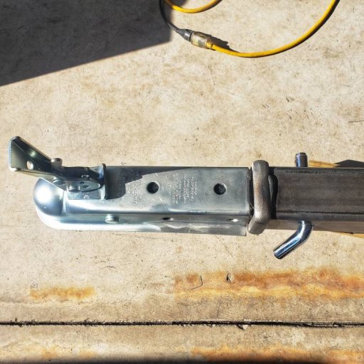

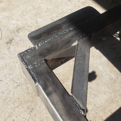

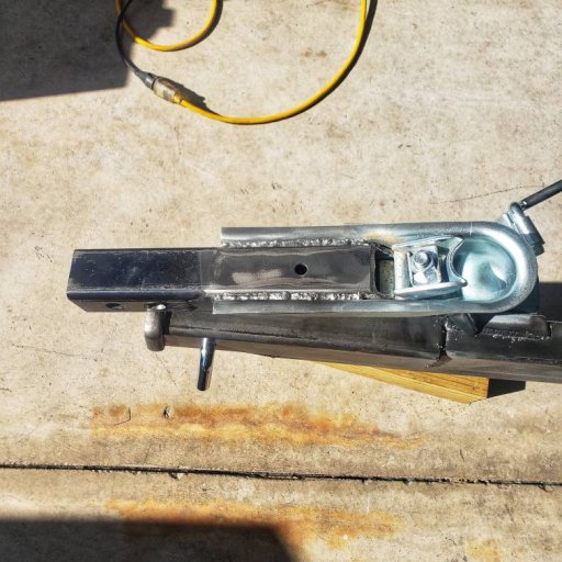

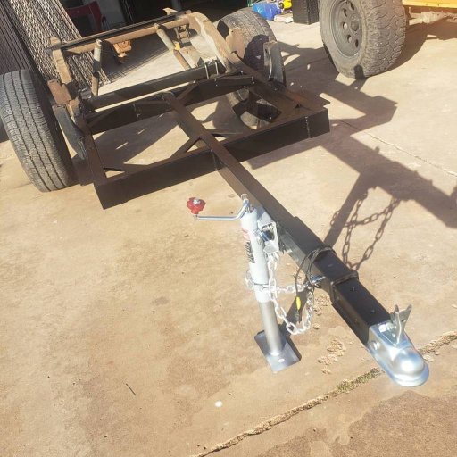

Got a bunch done on the trailer today. Removable 2" ball hitch welded up, Trailer tounge jack attached, corner caps on my front frame ends welded on, angle iron mounts for the front box welded on, and fabbed up a spare tire hoist behind the axle. I'm not that concerned with rear clearance. Picked up my new axle yesterday, but I'm waiting on my mounting bolts. I'm hoping I'll get that swapped and the bed back on before next weeked!20191116_112423-01.jpg20191116_112413-01.jpg20191116_112346-01.jpg20191116_112448-01.jpg20191116_112454-01.jpg20191116_153931-01.jpg20191116_153907-01.jpg20191116_153917-01.jpg20191116_153927-01.jpg

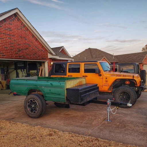

Got the new axle and wheels installed today! This raised the level hitch point up 9" overall and gives me 17" of clearance under the center of the axle. I'm pretty stoked to finally see it up off the ground. Tomorrow I paint the bare metal and hopefully we can mount the bed back on it Wednesday.20191118_163453-01.jpg20191118_163800-01.jpg20191118_164445-01.jpg

Haven't been working on the Gremlin through the holidays but it got an update this week! Stumbled across this utility shell on marketplace & it just so happened to be the right width. Unfortunately it's about 5" short, but I'm thinking that'll be a great spot to mount some accessories. Maybe fab up an expanded metal grid that I can mount various tools, tracks, or gear to. 20200201_163157.jpg20200201_163238.jpg20200201_163221.jpg20200201_163303.jpg

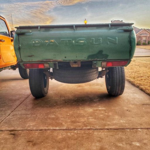

Took the Gremlin out on its maiden voyage last weekend. Loaded up my sons' Scout troop gear for a weekend Campout. Only got this one pic while they were still sleeping before we packed up, but it worked great. Only real issue I had was the trailer will rock or roll back and forth (side to side) while taking curves. I'm thinking the shocks need to be replaced. That's the cheapest solution at the moment. IMG_20200216_142607_829.jpg
