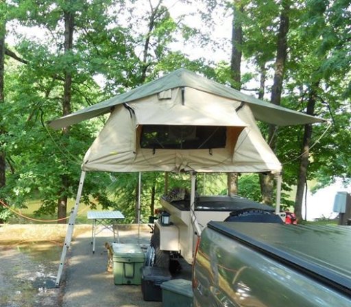

I'm curious what everyone uses for cooling system (fans, a\c units) in summer time camping while sleeping in your RTT?
I've found the Ryobi cordless fan really helpful in both van and my hardshell RTT when I want to get a cross breeze flowing. Open vents/windows at opposite ends and either have the fan blowing out so it pulls in air from the other side, or blowing directly at you. You can aim and tilt it to your needs and can hang it too, if needed.
It has a couple speeds and will last a long time on the low setting with larger 18v rechargeable. This one is dual power, in that you can use the 18v battery or plug it into 110. If you already have other Ryobi 18v cordless tools, it's a simple inexpensive solution (about $40 at home Depot, plus battery and charger if you don't already have them) that surprisingly gives a lot of comfort. I suspect other cordless tool systems have fans too. Ryobi also has one meant for garage walls, based on the same fan, but I think it's 110 only, not sure.
Here's a pic of the one I have and use a lot:
Can't do it with soft-sided tents, but I'm thinking of putting a small 12v vent fan in the hard top, too, which I'd wire along with a couple USB outlets in the tent for overnight charging of USB devices.
I've seen a guy who rigs a small 110 window AC for his ground tent when he camps in the Mississppi Delta region and power is available. More problematic, I suspect, to do it for an RTT.
I know another guy, out on Terlingua Ranch who made an effective swamp cooler to introduce cool damp air in his tiny home in the desert. Not effective in humid regions, though. If you want info on that, let me know and I'll find a link.
Most of the "Make Your Own AC!" deals I've seen made of 5gal buckets, water, small fan, and dryer vent hoses aren't very effective from what I hear. Fun project, though.
I'm interested in what others have done for cooling solutions, too.
