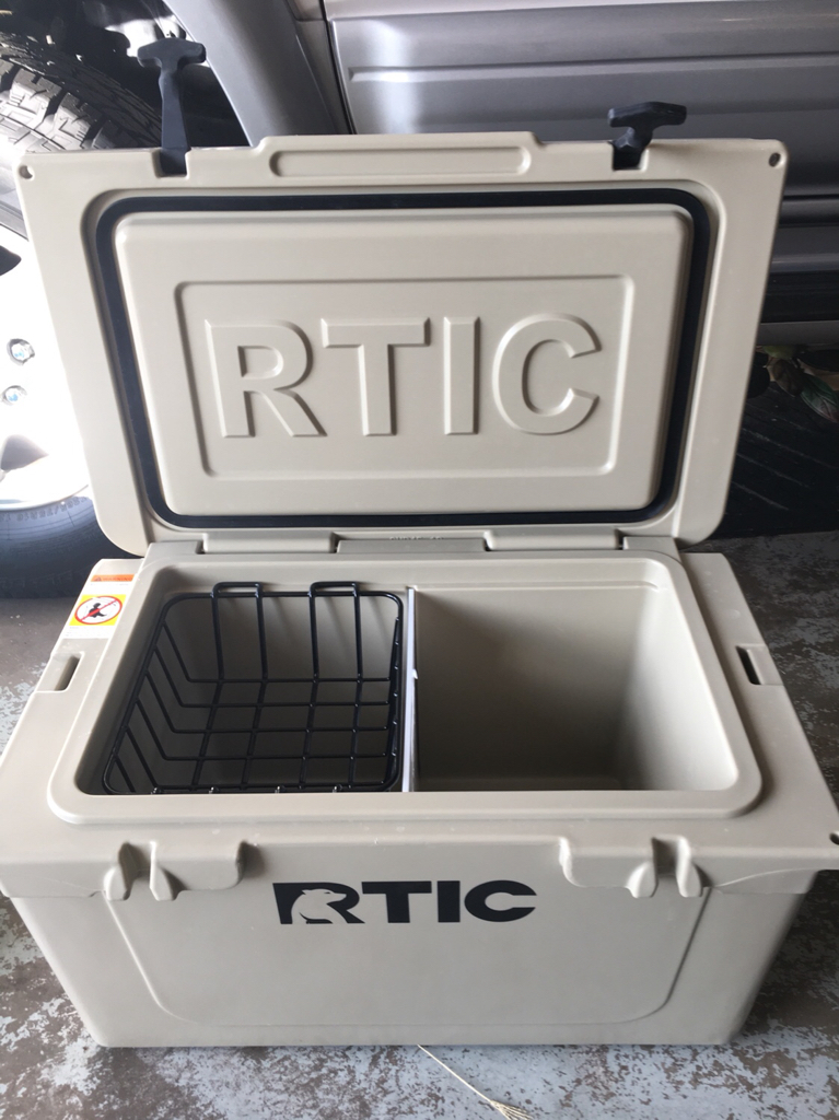

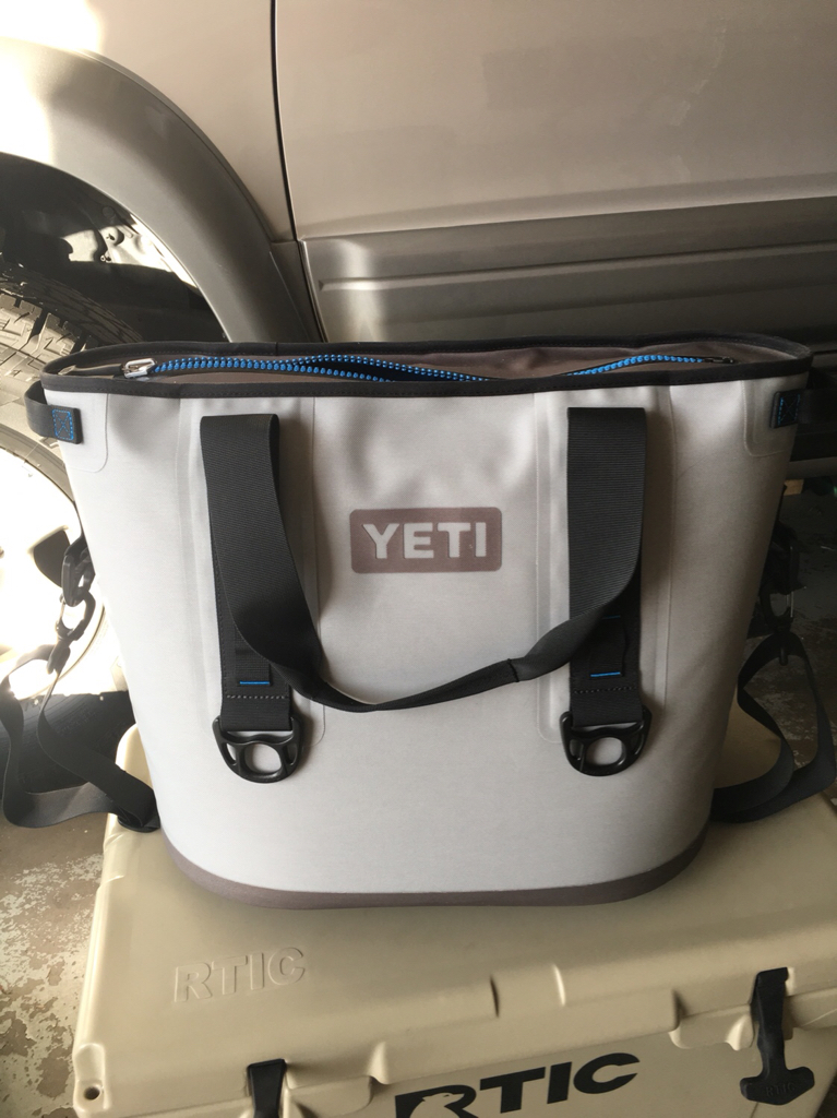

I told myself a few years ago I was going to get a fridge and it never happened LOL. Last year I got an RTIC 45qt and its been amazing. One day I'll get a fridge for the rig but for now my cooler setup does the trick.
I also have a yeti Hopper 30. The hopper fits perfectly behind the seat for drinks and snacks for the kids.
