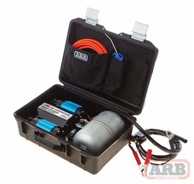

Has anyone ever seen a thread where they made their own portable version of this twin ARB compressor?
I've got one, and don't have room to permanently install it - so I wanted to put it into a Storm Case (about the same size as the one ARB sells), and power it similar to their portable product.
I'm just having a hard time getting it wired correctly to do so.

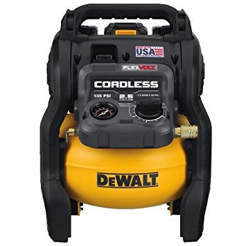

Putting this on my Christmas list. It battery powered and a “real” air compressor you can use anywhere. I already have more Dewalt stuff and batteries than any person really needs so it makes sense in my case.
