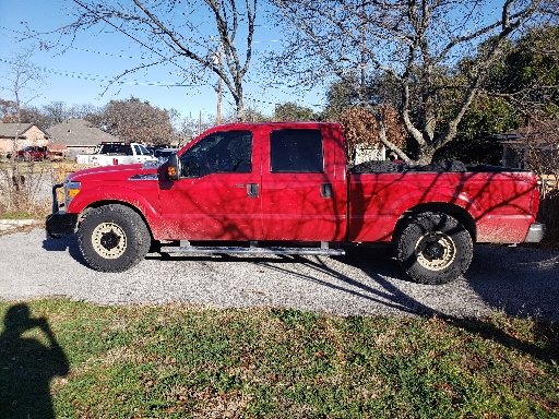

Ok so I've bought all this recovery gear.
>A 6kLB come along, its basically a stand in until I can get an actual winch and a bumper
>2 50ft pieces of 20k winch line, figured it was just like using a tow rope but longer and takes up less space.
>a 16 ft 6600lb chain
I do need another pulley to be on the safe side.
Heres the problem, the come along only has 6ft worth of reach and I fear that may very well not be far enough to get me out of whatever I'm in. Is there a way to reset this thing or something so I go another 6 ft?
I also considered replacing the steel cable with some synthetic winch cable to make the whole thing lighter as well as get more reach but I can't find anything on youtube about people doing it so idk if thats a thing.

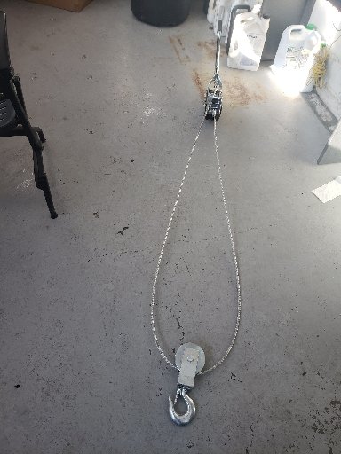

So far all I've got is making a series of doubled over loops like this one along at least one rope every 5.5 ft and 2 right near the end of the other rope, one loop to winch on and another to connect a short chain(?) to as a reset point.
Example pictured because I don't think I explained that well at all. Just imagine the chain is only like a foot and half long.

It can be reset with chain fairly easily on flat ground, on an incline not so much.
If your wanting to be able to reset fast and safe you'd need a min of 2 comealongs, you pull one to max then connect the 2nd one and continue pull then keep leap frogging them till you out of the obstacle.

I'm afraid I might end having to do that. I'd rather stick with one come along and add rope/chain as necessary but idk.

I think your gonna find that 6k comealong to be near useless though for pulling that f250 out of anything but a flat front yard. I have bent or broken quite a few of those on a lot lighter vehicle. Something that isn't talked about is those are only good for maybe 4 pulls at the max capacity before they become useless.

I intend to add another pulley to lessen the strain on it but I really hope I don't need it.

Check out some hilift videos on youtube. They use a section of short chain to lock the truck in place, while the hilift jack is reset. Would that work with your setup?
A hilift gets a 10,000# truck out easy enough. We're usually hardly stuck. Just found a super soft spot and sunk in when the tire dug.

I'm starting to think thats what I'm going to do. The only reason I didn't buy one in the first place is because I wanted something a little compact as dont yet have a real place to mount it.

Hi-Lift has a ORK for winching with the jack, you need to have 20' of G80 chain. You can do something similar with a come a long. It's slow but works.
