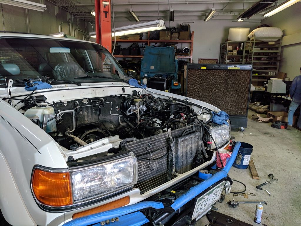

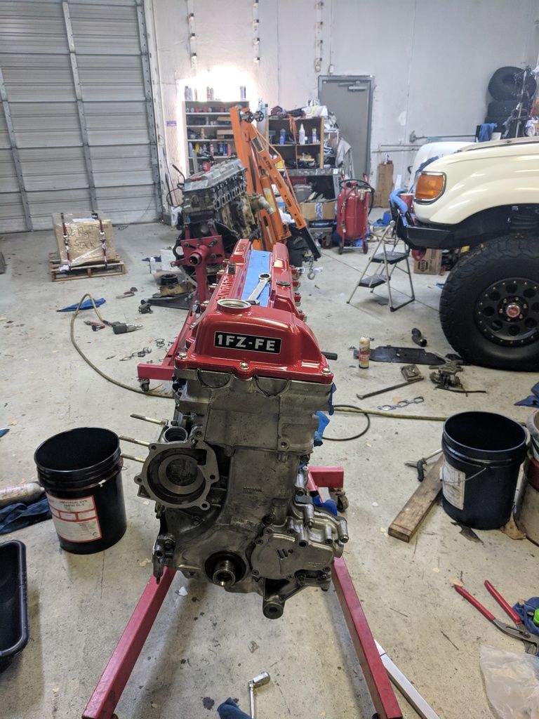

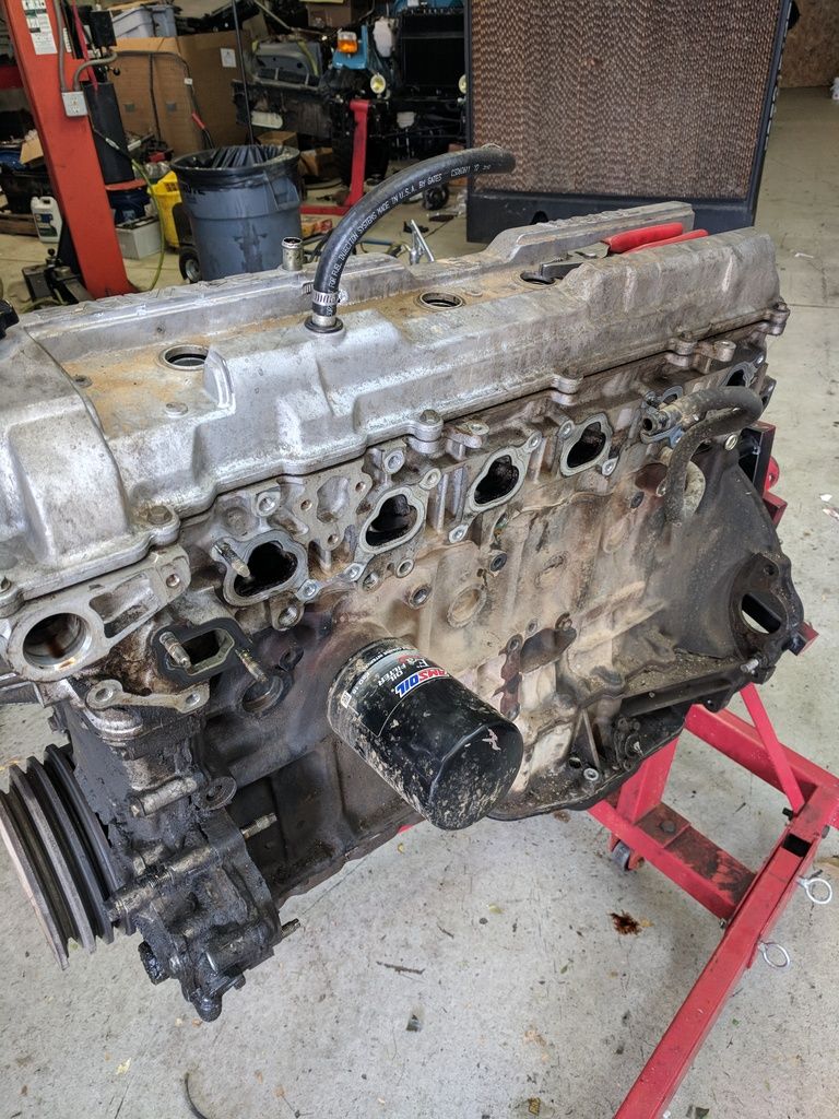

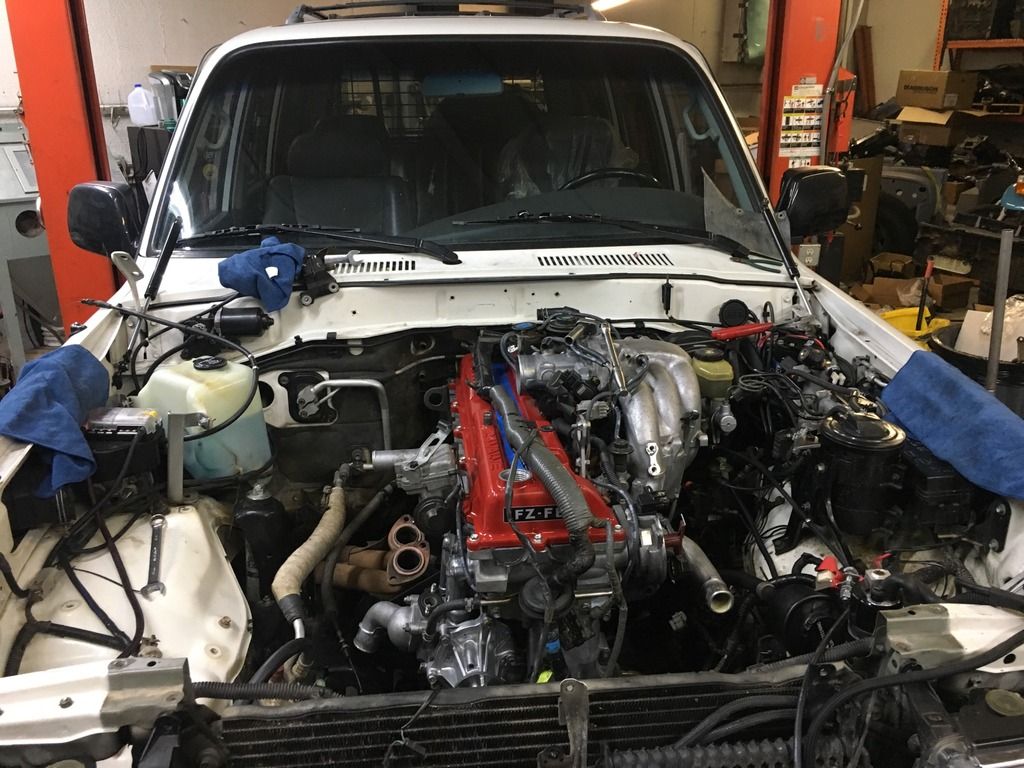

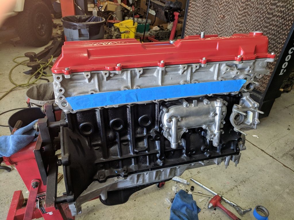

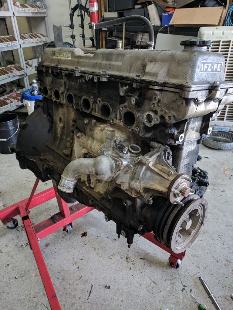

OK big week for the rig. Dropped her off at Robbie's for motor swap. Here are some it pics of the swap so far. Also a big thanks to Onur for getting all the Toyota parts in so fast.
The old motor. It was still running strong just a few oil leaks.

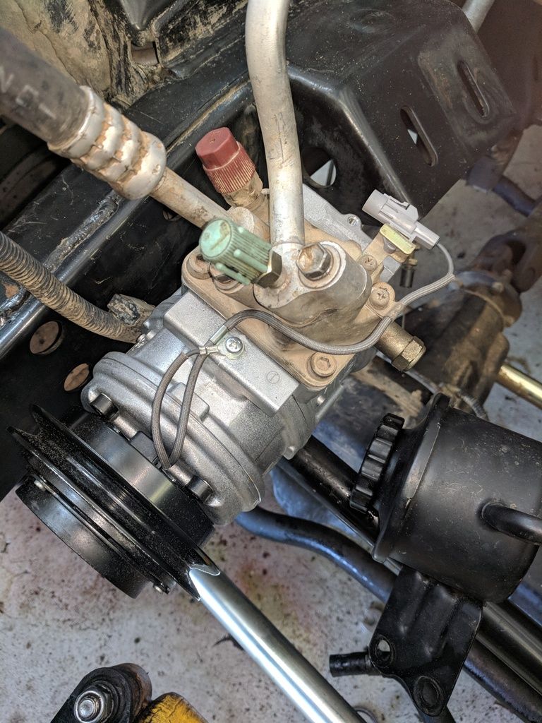

Cleaned up the engine bay a little and replace the throt;e cable and AC while the motor was out.
AC replacement

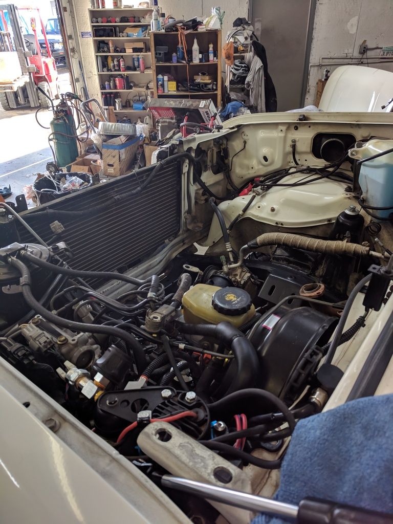

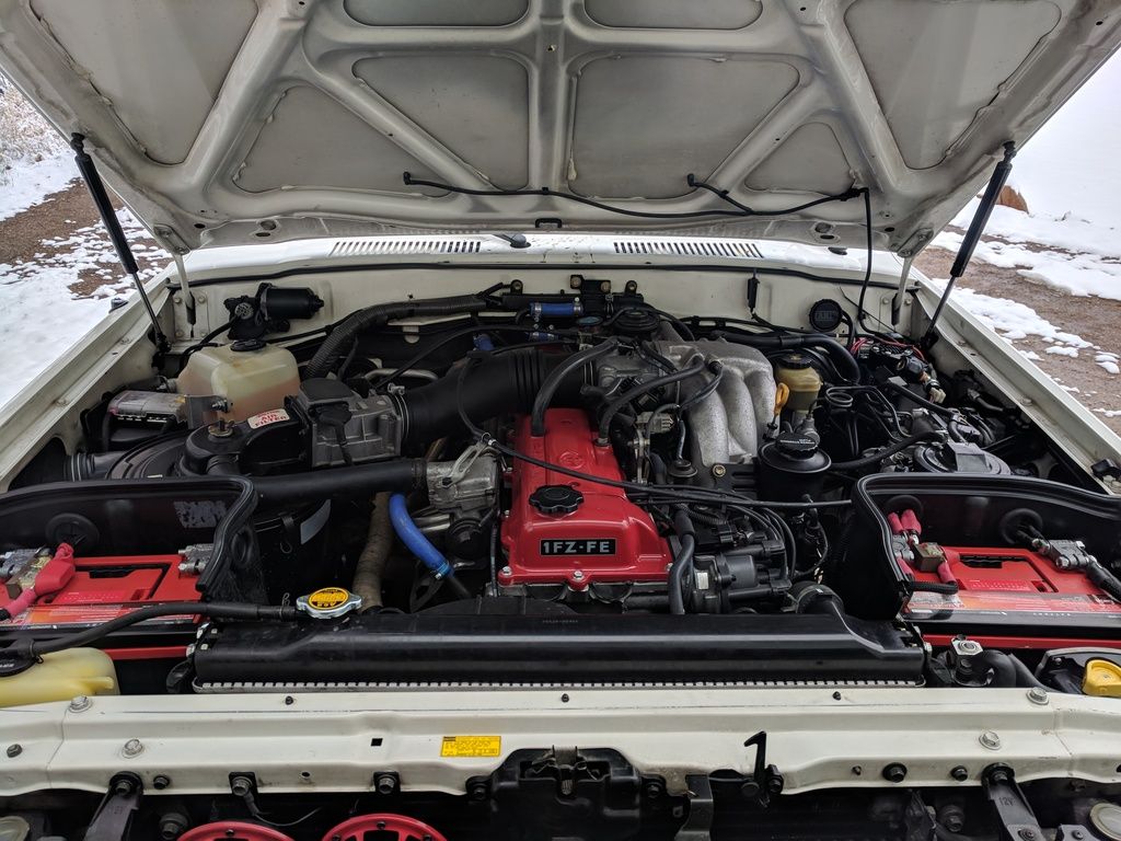

Did a little work on the getting the dual battery's back in and cleaning up the wiring. Engine looks awesome. Not sure how I feel about the purple hoses. Have to order some more parts from @NLXTACY. I will say I love Robbie's attention to detail. Exhaust is next.

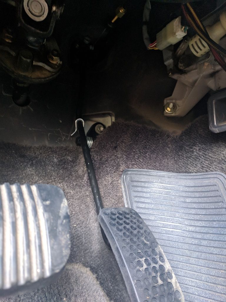

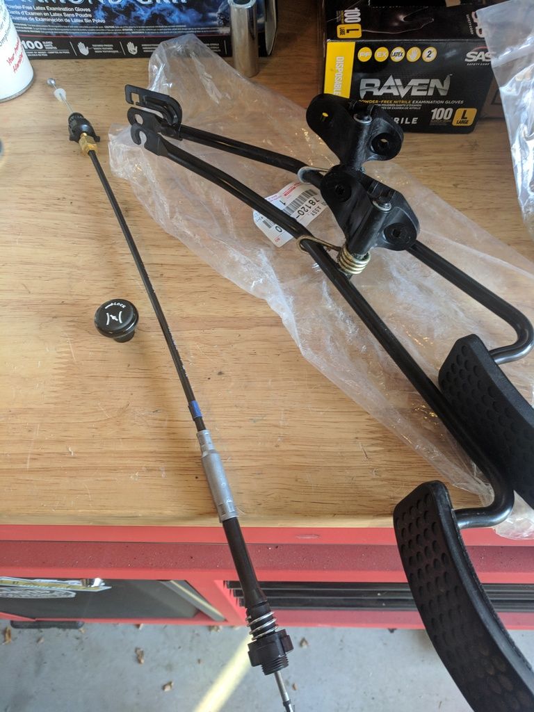

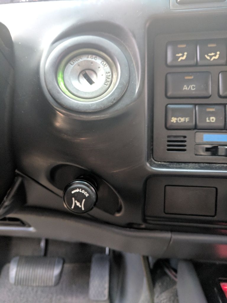

Had some down time before work this week so I installed the hand throttle kit I bought. Works great and should help out when filling tires and winching. Thanks @beno for sourcing the new foot pedal.
Reactions: Jimmy P

Please excuse my ignorance. If I may ask what is the use of the hand throttle when filling tires and winching? Is your onboard air compressor/winch RPM dependent? Is it more the lock at a various throttle position than the hand control that you are looking for?
