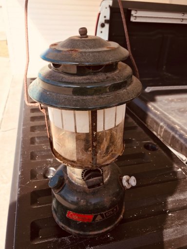

I drove down to a neighbor's house to look at a welding job he needed to have done on his debris trailer's tail-gate. While I was there, I saw a couple camping lanterns sitting outside on the ground. One was a no-name and the other was a Coleman. I asked about them and he said he was going to put them in the trash. He asked if I would be interested in having them. Well, "Yes", I said. :smiley: I left with the Coleman only. The model is a 290.
It still had 1/4 tank of old smelly fuel in it. I taped all around the tank and it seems solid. It need some TLC. I don't see anything wrong with it, other that a slightly bent thumb-nut stub on top. I'll disassemble it for inspection and replace whatever parts it will need.
Does anyone know how to tell the year it was made?

Look at the bottom of the fount. Should be stamped month and year. Looks like late 80s early 90s.
Thanks. I'll look in the morning

TerryD, it's stamped 6............................84
Ok! I had it in my mind they switched to the CLX badging in the late 80s. My bad!

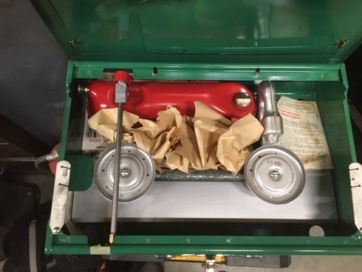

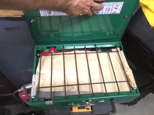

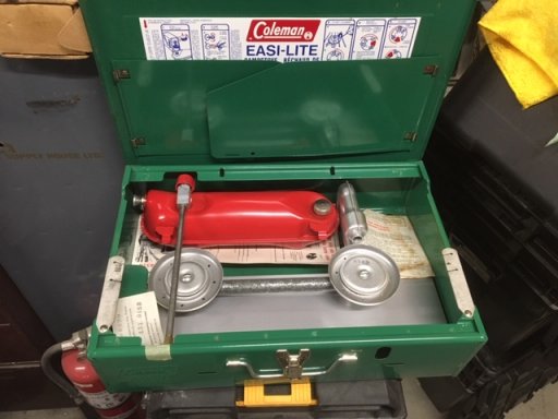

My $5 find yesterday!
Supposedly it just needs a pump. It's much nicer than my current 288a, which is my truck lantern, and I thought it was only the case till I picked it up. That puts me about 4 deep on "The Healing Bench" now.... haha!
