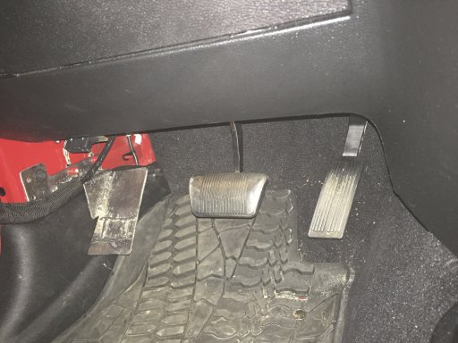

the first mod was fabbing up a dead pedal. our first road trip I was searching for a place to rest my foot, Its a bit hack but it gets the job done. I still need to adjust it further out by about an inch but it works,Clifford_3994.jpg

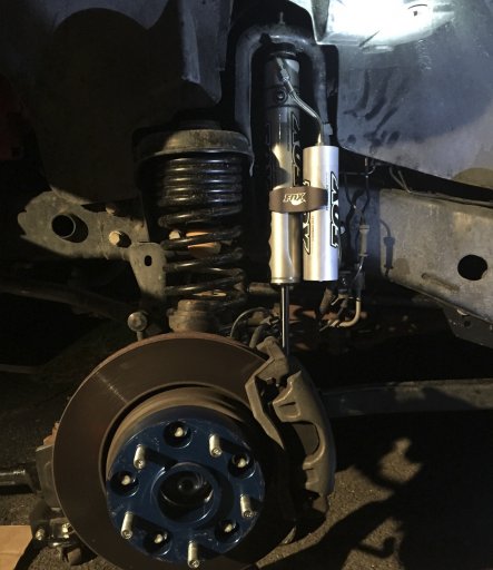

I ran the stock shocks for about a week while i waited for my Fox 2.0 Resi shocks to arrive. even without the new shocks the difference in ride quality was very noticeable.
once the new ones were installed the ride was even firmer and more controlled, A bit of dremeling needed to be done to install the new ones on the passenger side.

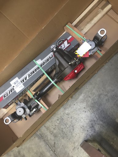

This is where things start to get interesting. I had been a member of JK forum for awhile, and with the luck on winning the light bar i figured, why not enter every contest i come across...I entered in their mega-awesome prize pack giveaway for a Currie RJ44 Housing, ARB, Ten factory axles and adams driveshaft and was the lucky winner! i responded to the post at minute 4 of 5 of my timeframe and in January a really heavy giant box showed up at my offices loading dock. Clifford_6567.jpg Clifford_6624.jpg
I opted for 4.10 gearing. This decision was solely based on staying in the 33-35" tire range with the 3.6l engine. its been great and I wouldnt change how its set up. when i regeared the rear i also put an ARB in there

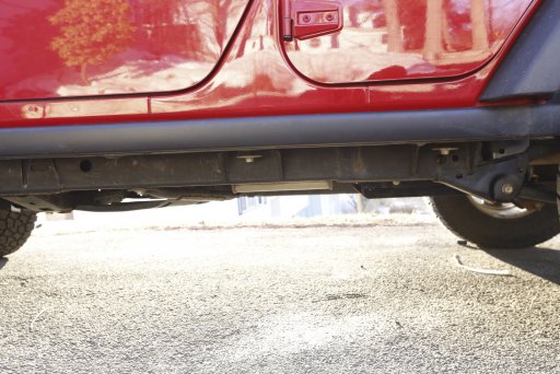

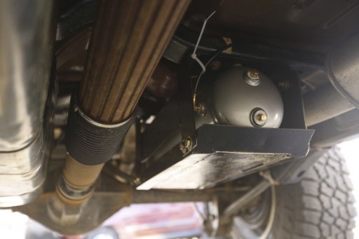

running the ARBs finally pushed me over the edge to install my air tank that i had been holding on to. I looked at a few different tank options and decided on locating it where the Evap was.Clifford_6767.jpg Evap got relocated over axle and after a battle with a CEL from an upsidown Leak detection pump I made a custom skid box(I still have the templates for it if anyone is interested) . It sits a little higher than the gas tank on the opposite side. More to come later....Clifford_6763.jpg
