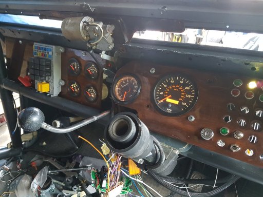

This car started off as a rusty wreck that I bought for £800. 18 months later and it now looks like this! Everything (apart from the roll cage) was done by myself as a learning experience, and what experience that was! Every modification has been done with overland travel in mind, and there are still things to do.
The list of mods (that I can remember) are:
  • BMW R1100RT motorbike engine. The original 602cc engine offered an exciting 29hp. The new, fuel injected 1100cc engine offers 95hp and the reliability of a proven adventure bike. With a weight of 650kg (1433lbs) the performance is surprising!
  • Quaife ATB LSD I’m the original 2CV gearbox for improved loose terrain grip. It’s amazing that these gearboxes take 3 times the power without any complaints with very minor modifications.
  • Custom made roll cage, including supports for the Sparco Sprint seats and Sabelt harnesses.
  • New, upgraded galvanised chassis.
  • Reinforced suspension throughout, including VERY upgraded suspension arms and updated springs.
  • Banded wheels to fit substantially larger tyres (165/80R15) . Still small by modern standards but much larger than the original 125s
  • Wiring harness for the entire car (including engine) made from scratch.
  • Fuel system built from scratch to accommodate the injected engine.
The list goes on, but those are the main points. There are still things to do but the first 3000 miles in the car have been a blast! Just need this stupid virus to go away and start going places.
