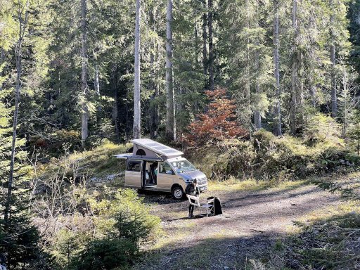

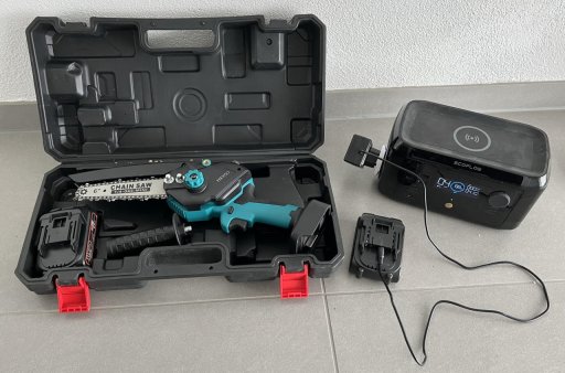

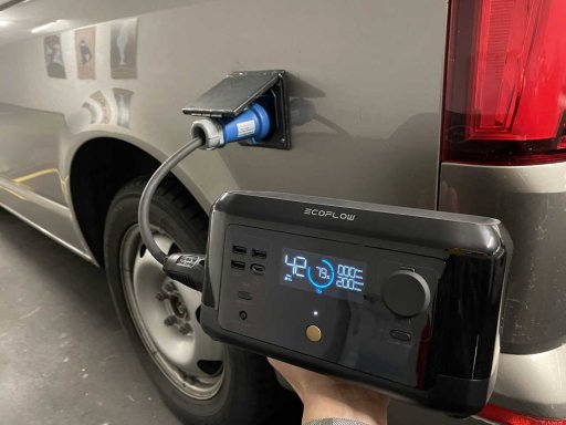

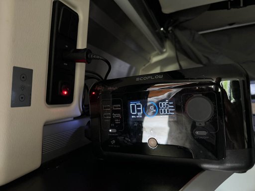

Here is my Setup, which I did optimize over the years:
3x Solarpanels on the roof for my AGM Batterys
Ecoflow River Mini as the 220v Inverter (300/600W) for eBike, Battery-Aircompressor, electric Mini-Chainsaw Battery, AND 100W USB-C for Notebook, Tablet, Drone, Phone
Charging the Ecoflow River Mini by 12v inside of my car by 85W from the AGM`s
At the beginning I had a mich bigger Ecoflow River Pro, but for my purpose the smaller unit was still good enough, much smaller and more lightweigt. From my Solar / AGM Setup there was still enough juice for fridge, 12v Water heater, lights and so on.
I did wrote some reviews who are linked too above. Please note that I own that stuff since a while, some of the grear is replaced with newer Versions or isnt available anymore...

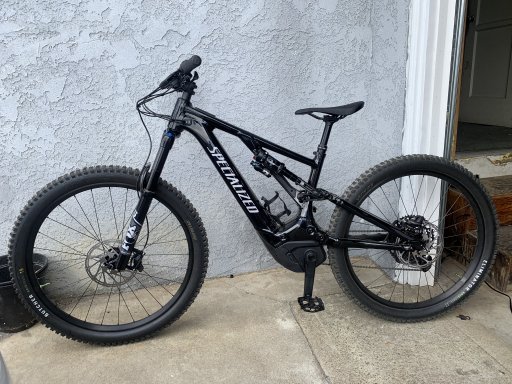

Does it look like this?
I have a Levo Turbo and an Aventon Aventure2.
I like the Aventon but its too much of a street orientated bike. What I do like is it will go 30mph pedaling and 22 mph on the throttle. Odds are I'm going to sell it. I like the Levo much more.
On the Levo, 1st gear was too low for me and second wasn't much better. I went up (i think) three teeth on the front gear. That made the gear ratio better for me. I also unlocked the speed cap but about 25 mph on street is about it. If I pedal faster I can hit 28.
Due to an injury I haven't ridden this winter. I'm starting back probably next week.
BTW. What part of LA you in?
