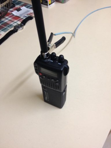

The stock antenna is not too bad for close range stuff....in the car i use a whip on a mount....http://www.jaycar.com.au/Sight-&-Sound-Car/Car-Audio-Hardware/Car-Hardware-Accessories/3-Foot-27MHz-Helical-Whip/p/DC2030
and when on foot i usually hook up the Cobra telescopic antenna...http://www.ebay.com.au/itm/Cobra-HATA-Telescopic-Whip-Antenna-/191534366072

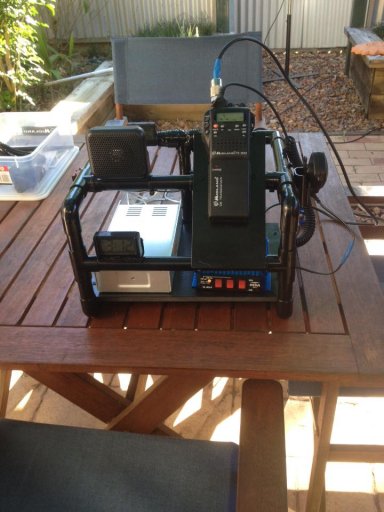

Thanks for the information Luis! I really like that Cobra Telescopic antenna! Under normal conditions, what kind of range do you get with the Cobra antenna. Also, you have to tell me what the home station in the photo is all about.

If you are in the vehicle there is no better option that an external antenna, the vehicle acts like a steel cage as far as the radio is concerned...on foot i have gotten about 7 to 8 kms with the cobra, that was in suburbia...so in the open landscape you should get a better range !

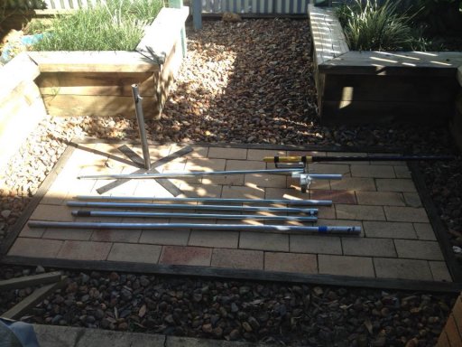

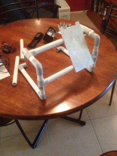

The home set up is the radio with an SO239 adaptor which allows me to connect a Workman B100 external antenna on a 5 meter mast, i run a 30 amp power supply to power the linear amp KL203P...i have a clock / hygrometer and external speaker set up on the home made rack !

something that helps also is a counterpoise....wire on an clamp....in this case 2.750 mts... a quarter of 11 mts ....adds a good ground-plane the radio is much more responsive
