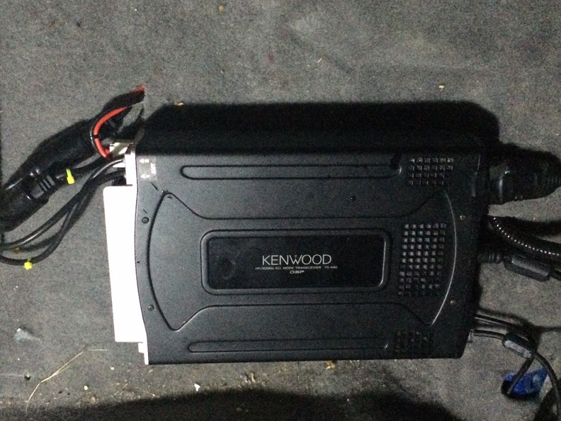

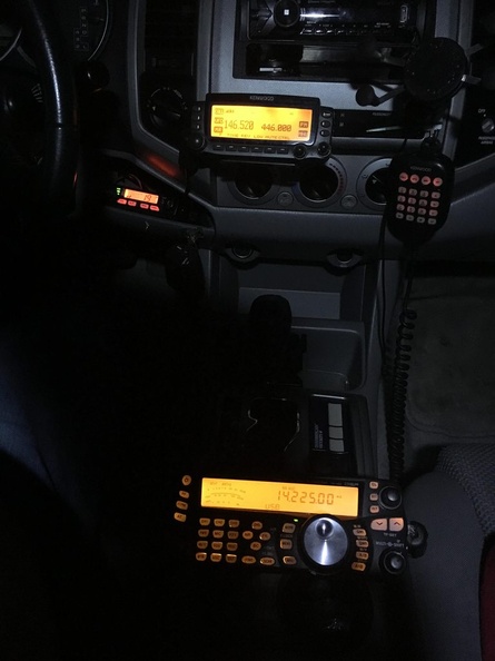

MarkW, Many of the mobile VHF/UHF units have detachable controls. This is a bit more than the Cobra 75, but if you look at the photos of my truck, you'll see that most of the radio components are mounted under the seats, with only the control heads, and mics exposed
This is under the driver's seat. (seat removed during installation)
Very nice @Lars I will definitely be doing some more research and most likely adding HAM this coming year.
