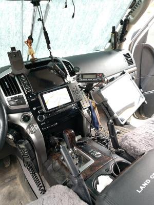

New to overlanding and offroading, and now tackling comms. I bought both types of radios. Now figuring out what goes where.
I'm thinking if I'd only need one type of radio at a time (true? false?) then I could:
Mount both radios side by side
They could share an antenna mount
They could share a mic
Kind of feels like it could simplify the look/install/etc of everything. Thanks in advance for any opinions!

Sounds more complicated than it has to needed. What are both types of radios?
I'm running CB, GMRS HAM and a cell booster.
Cell booster: Weboost drive reach (installed, that's the one up top) with the Wilson truck antenna
GMRS: Midland MXT400 (finishing install today) with the ghost 3d and longer 6db antenna (ghost for city and longer for trail)
CB: Uniden PRO505XL with the FireStik FL3-B 3' FireFly antenna
I'm excited about the GMRS, and the CB is mostly so that I don't miss out if that's what the group is using...

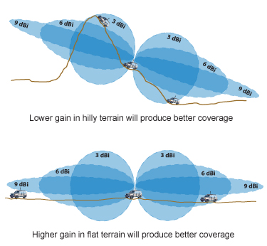

Just install both radios and two separate antennas. I have a primary radio spot and a "secondary" radio spot. THe secondary spot is typically setup for a basic APRS setup but I can easily throw in my CB radio as well. I run a NMO mount on each fender. The passenger side one is either a 1/4 wave VHF for APRS or a NMO CB antenna. A Browning BR140 antenna.
As far as the different gain antennas. You may actually find the 3db antenna to be more effective off pavement. The higher the gain the more the signal is "pinched" towards the horizon where as a lower gain antenna can provide a more "round" radiation pattern. This means in an off pavement situation where the group is spread out by distance AND altitude the higher gain antennas may be firing your signal straight into a mtn side where the 3db antenna will project the signal "up" and "down" better. This also has the advantage of the shorter lower gain antennas being less susceptible to getting ripped off by foliage.
