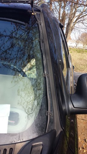

The hard part for my car is to run the wires up the windshield gutter to power the lights on top.Agreed. And it's just so nice that the only thing you have to run through your firewall to the interior of your vehicle is the cable for the controller. All the actual accessory wiring stays in the engine compartment. With a home-spun fuse block and rocker switches arrangement, you'd have wires going through the firewall for every single switch.
get out the hole saw and go through the roof. hahaThe hard part for my car is to run the wires up the windshield gutter to power the lights on top.
Yeah.... no... not doing that. Not doing that at all.get out the hole saw and go through the roof. haha
In all seriousness though, it would require more wiring, but could you potentially chase the wire up the b or c pillars? or maybe go from the engine bay along the frame under the vehicle and then chase it up the tailgate or trunk sealYeah.... no... not doing that. Not doing that at all.
Yeah... that is why I need to outsource the electrics. Most of the underside of my car is covered by skid plates or plastic cladding. The only thing that isn't is the exhaust.In all seriousness though, it would require more wiring, but could you potentially chase the wire up the b or c pillars? or maybe go from the engine bay along the frame under the vehicle and then chase it up the tailgate or trunk seal

I wouldn't go through a car wash no...Quick question...Does anybody use a drive through car wash with roof lights?
Looks great to me. How long has that been on there? Just curious how well the stickiness holds up over the long term.
